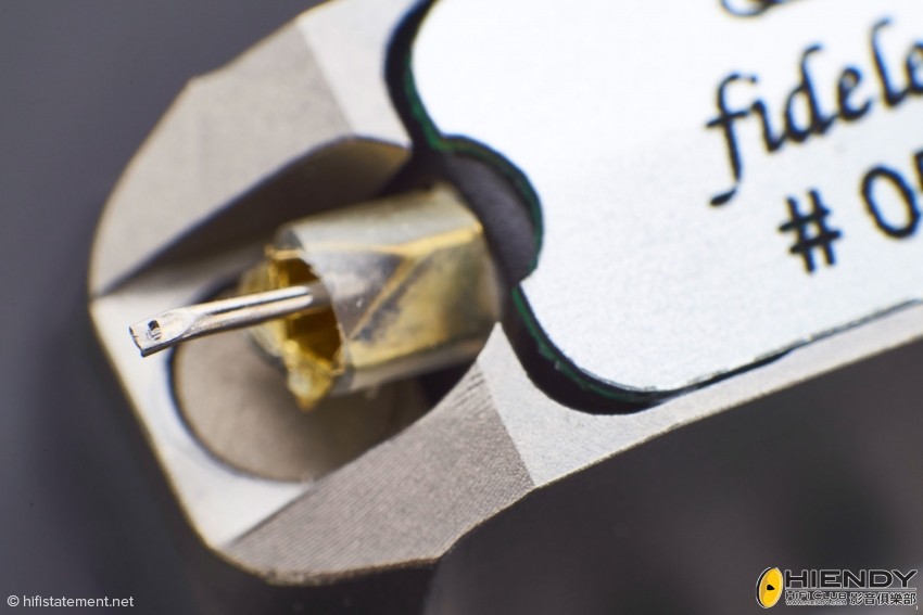

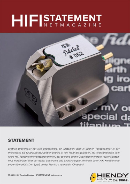

德國acoustical systems 推出空前實惠唱頭 Fideles.  Fideles 拉丁語代表忠誠,也是設計司兼老板Mr. Dietrich Brakemeier在設計Fideles的設計理念.  Fideles 著重音樂味濃,富色彩同時亦不失動態和分析力. fideles_04_300.jpg fideles_06_300.jpg
Fideles以MI(動鐵)為驅動模式, 配合AS引以自豪的 Titanium Timet 1100 鈦金唱頭外殼, 能有效發揮MI頭的魅力.  唱放一般在35db-50db增益就能搭配得宜. 跟其他AS唱頭一樣, Fideles機身有3組鑼絲孔,確保配搭任何唱臂都可調整到所須超距(overhang).   fideles_02_300-1-1.jpg

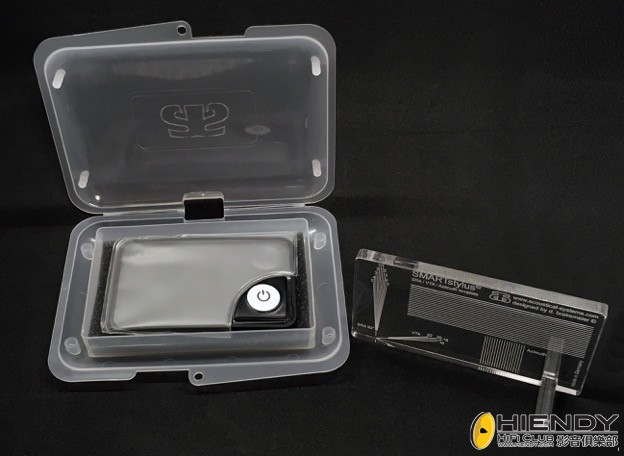

用埋acoustical systems SMARTstylus 來調較, 更如虎添冀.

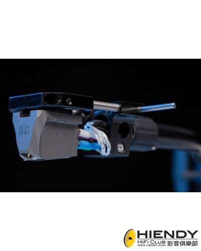

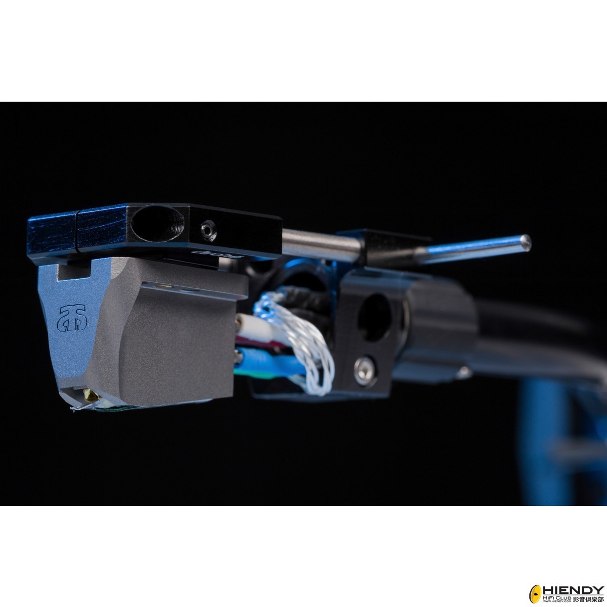

acoustical systems 唱頭有3組鑼絲孔.  可以方便任何唱臂都能調整到超距

The fidelis is suitable for any MM input on a preamp made over the last 50 years. It has 5.5MV out put. What does that mean? It plays 7db louder than a cartridge with 2.5mv so when playing music you can turn the preamp down 7db many preamps especially tube and vintage will have much less background noise and give us that black back ground we are looking for. This stylus is a very small true elliptical 2.5µ x 7µ. A common cartridge like an Ortofon bronze is much larger at 8 x 40 µm. This mean the fidelis stylus is 68% smaller allowing the stylus to ride much farther down the groove allowing for better detail and more resolution. For many customers they are playing a part of the groove that has never been played before thus reducing noise. The other benefit of riding lower down in the groove is related to frequency and dynamics. Bass waves are long and produce wide easy to see modulations on the record surface. As the frequency goes up the wave gets shorter and the modulation of the grove becomes less, very high frequency are tiny and at the bottom of the grove.
