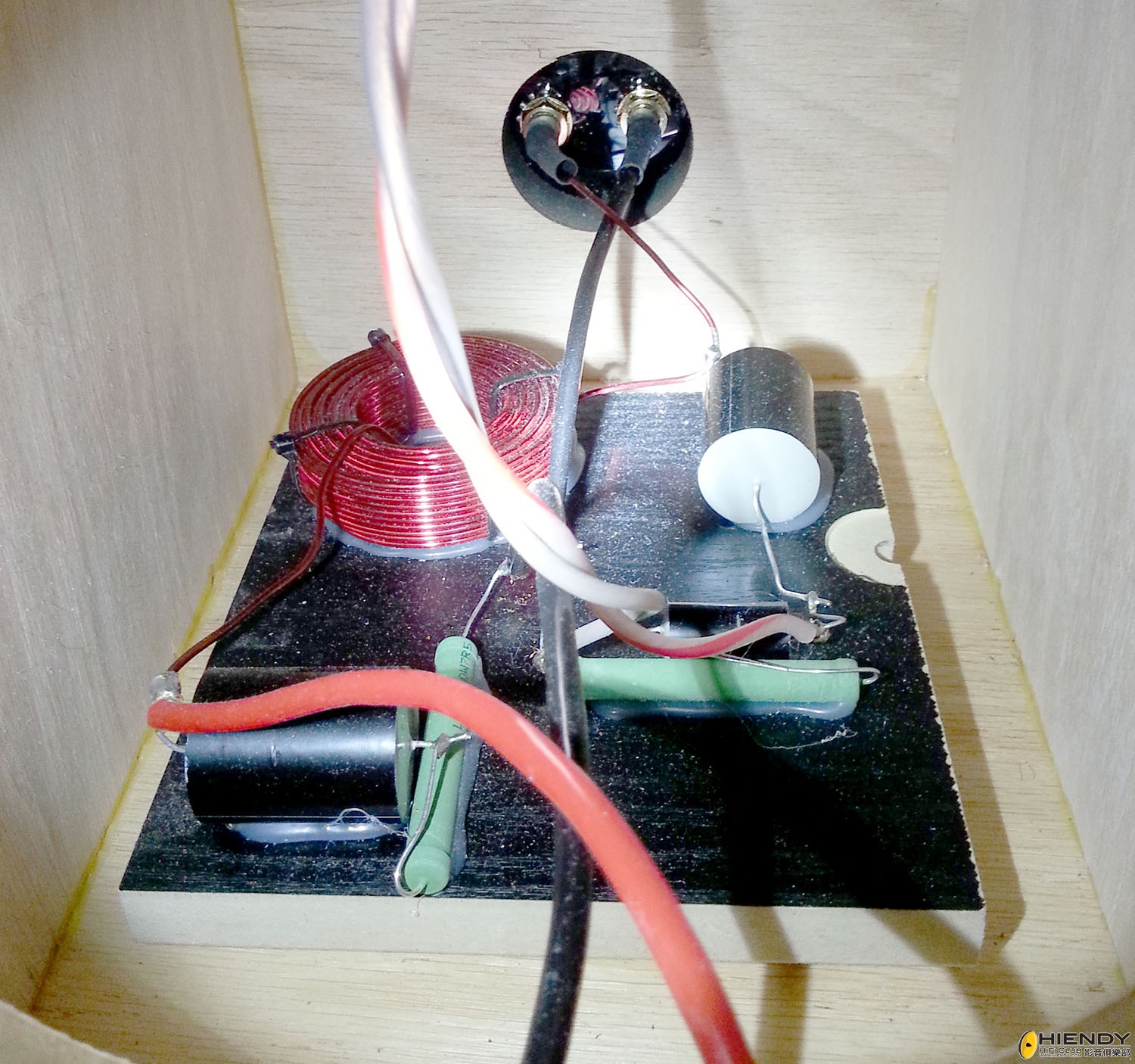

...我又身痕...想upgrade喇叭電容. 開喇叭後發覺電容上完全冇字同markings.
請問點可以知呢幾粒係咩電容同佢地既值呢? Thanks in advance.

哇!个分频器好简单喔...将只电容拆出来;拿去卖电容的档口用专用的电容表一测就清楚了...

應該1st order
低音加CR circuit 做阻抗補償
高音電容加CR都係阻抗補償
右上角電容係critical
可換好d

本身用料都不錯,電容似是SOLEN
發表於 2013-7-12 08:16:16 | 顯示全部樓層
電感都似係solen 七芯

Hi Bigdish hing,
if you want ,  you can bring the speaker to my place and we measure the value for capacitors and inductors.
Cheers!
blau
