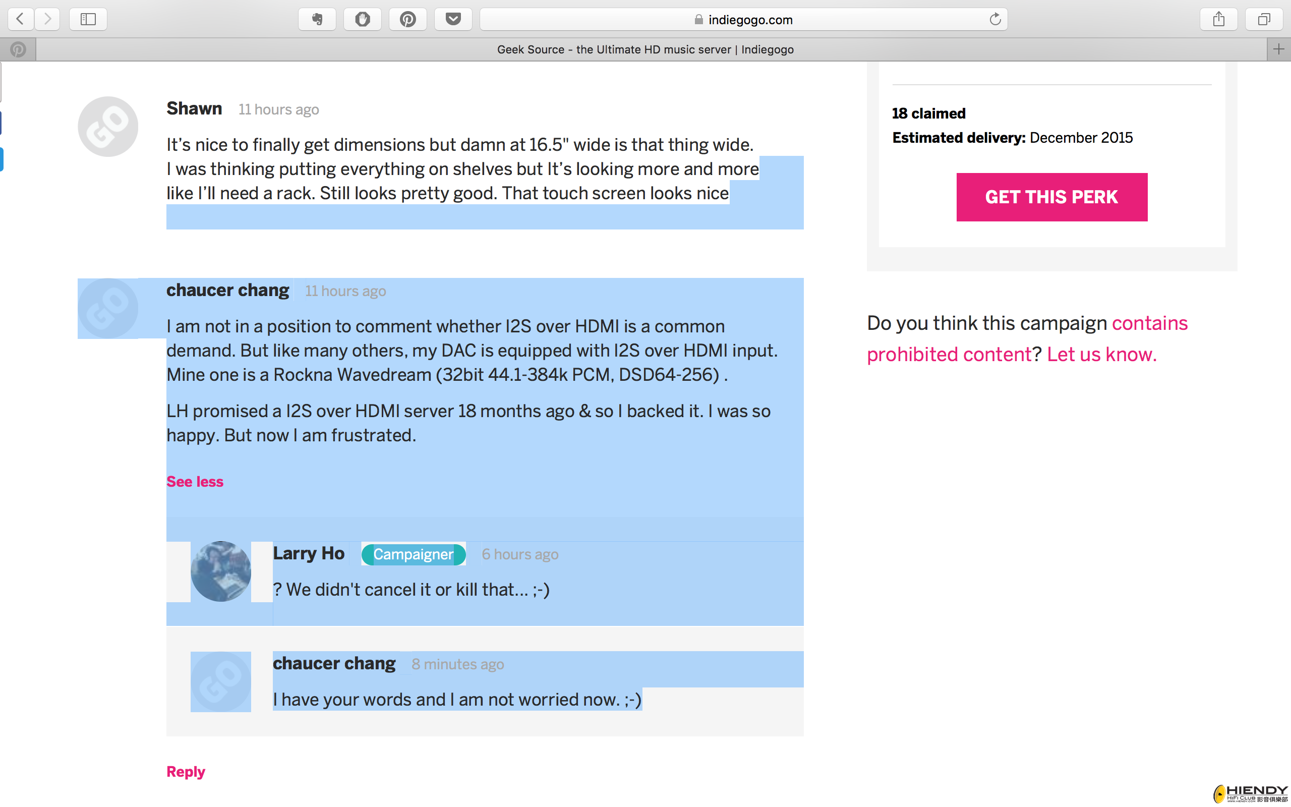

chaucer 發表於 2015-12-12 18:11
LH is spinning off the Source into another campaign.
I2S over HDMI feature that I need badly is go ...
resolve conclusively

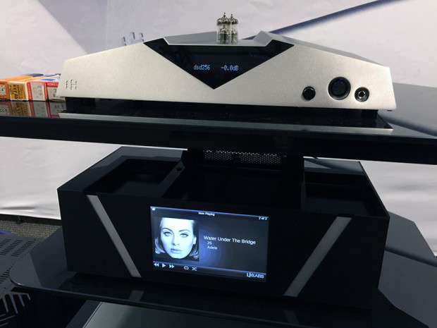

Source case and interface, Vi Dac Tube above

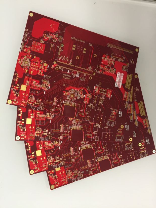

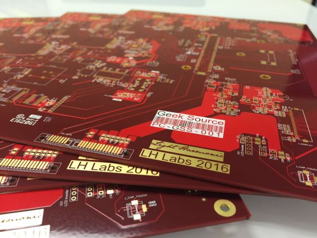

Have PCB......only....
