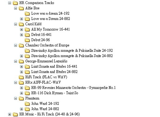

Comparison of Different Resolution Audio Tracks
