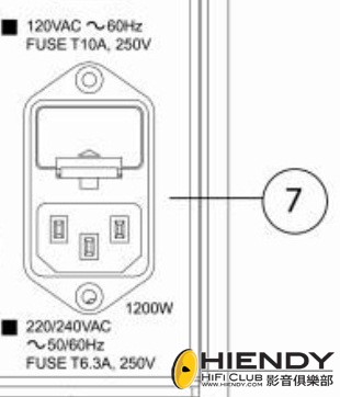

 樓主| 發表於 2012-9-13 23:55:25 | 顯示全部樓層
the amp can do both 120 volt 60 hertz and 230 volt 50 hertz as per seller

 樓主| 發表於 2012-9-14 00:21:41 | 顯示全部樓層
see
發表於 2012-9-14 00:37:21 | 顯示全部樓層
You need to change the fuse also, better ask Cary beforehand.

micma 發表於 2012-9-13 23:55
Ask him how to do the voltage conversion if he really knows.

發表於 2012-9-15 07:22:51 | 顯示全部樓層
micma 發表於 2012-9-14 00:21
see
問廠就最好.問佢地d機個voltage係咪universal.
不過而家好多機都係universal電壓架喇.
睇你比出泥個圖樣220v應該無問題,亦都唔千期唔好換fuse.因為佢都寫明10A for 110v,6.3a for 220v.
