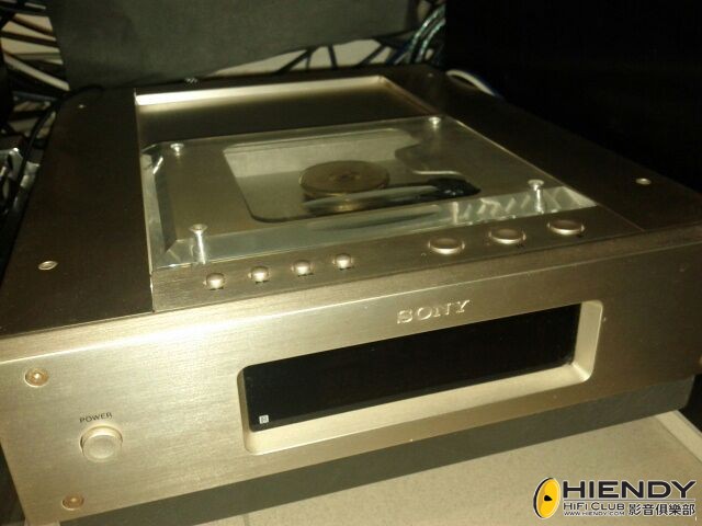

(SONY CDP IN MY ANTOHER POST WRONGLY INCLUDED AS ATTACHMENT AND CANNOT BE DELETED)
