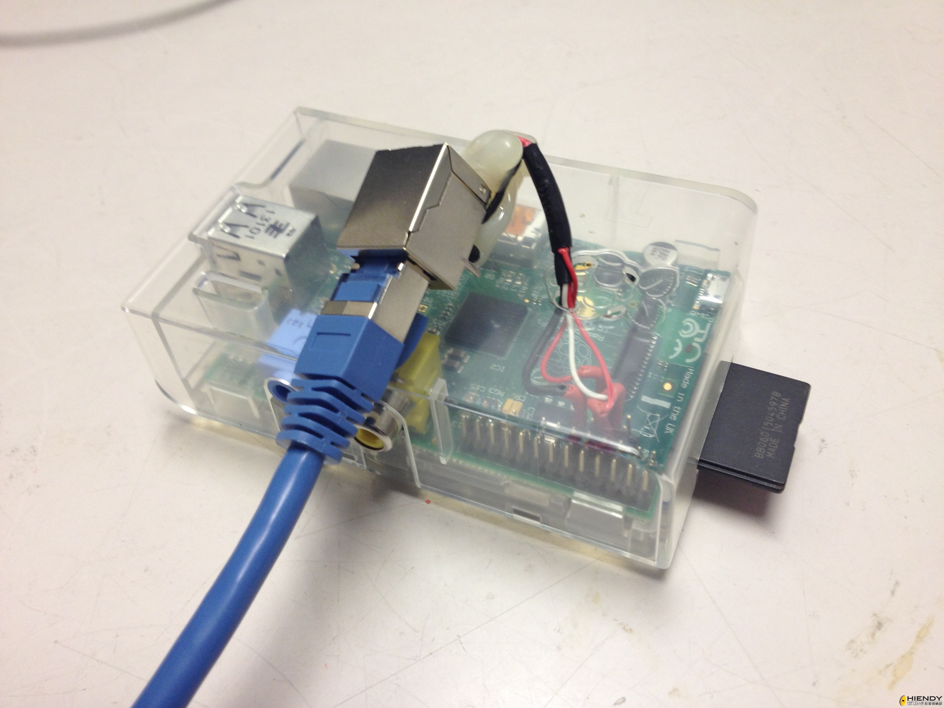

Bypassing USB, using kernel I2S, supported by the newest version of PiCorePlayer as well.

師兄,後面重有物跟尾?

Hammondlo 發表於 2014-1-18 00:02
師兄,後面重有物跟尾?
Nothing, just 4 wires connecting to P5 and a RJ45 socket.

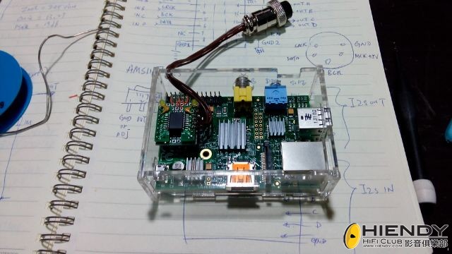

發表於 2014-1-26 17:25:24 來自手機 | 顯示全部樓層

我都有唔洗mclk既dac,
不過會局限左使用方便性
_____________________
琴日試左好正常,dac lock到i2s訊號
今日裝埋數位隔離器上機再試下,睇下提升多少
 樓主| 發表於 2014-1-27 06:41:04 | 顯示全部樓層
zoneaudio 發表於 2014-1-26 17:25
CKL hing thanks
我都有唔洗mclk既dac,
比 USB, 提升好大大大大大.....

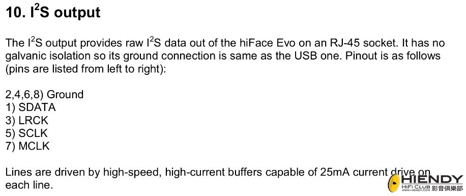

發表於 2014-2-28 14:59:21 | 顯示全部樓層
Hi CHING can you share which 4 pin out of the 8 pin from the RJ45 are connected to the p5?
 樓主| 發表於 2014-3-1 17:30:44 | 顯示全部樓層
steve_salsa 發表於 2014-2-28 14:59
