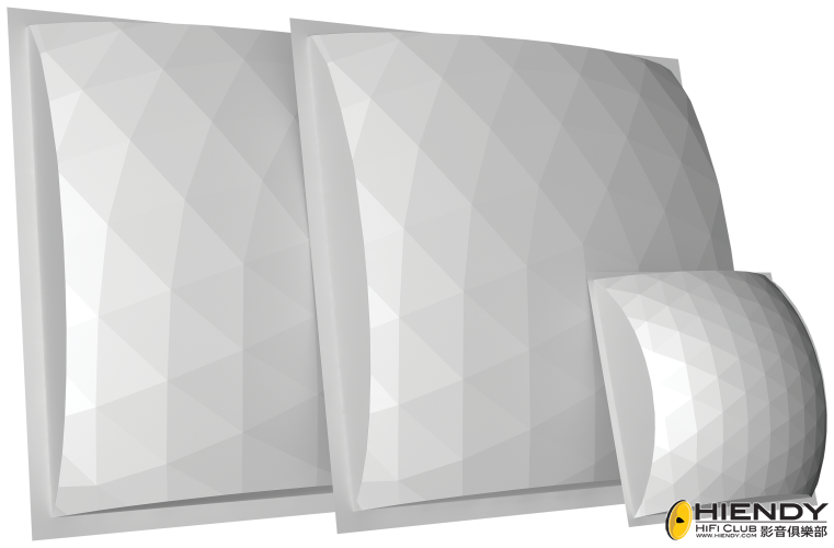

想試下搞下Room Acoustic,最近已經放左四塊吸音棉在喇叭後牆第一反射位,聽過要用吸音棉溝擴散板聲音先最好。現在想試下放擴散板在喇叭中間後牆。有什麼牌子介詔? 留意過Vicustic 但size 太大了,又有留意過Kryna,  但size 又好似太細。重有無其他介紹下我。 thanks

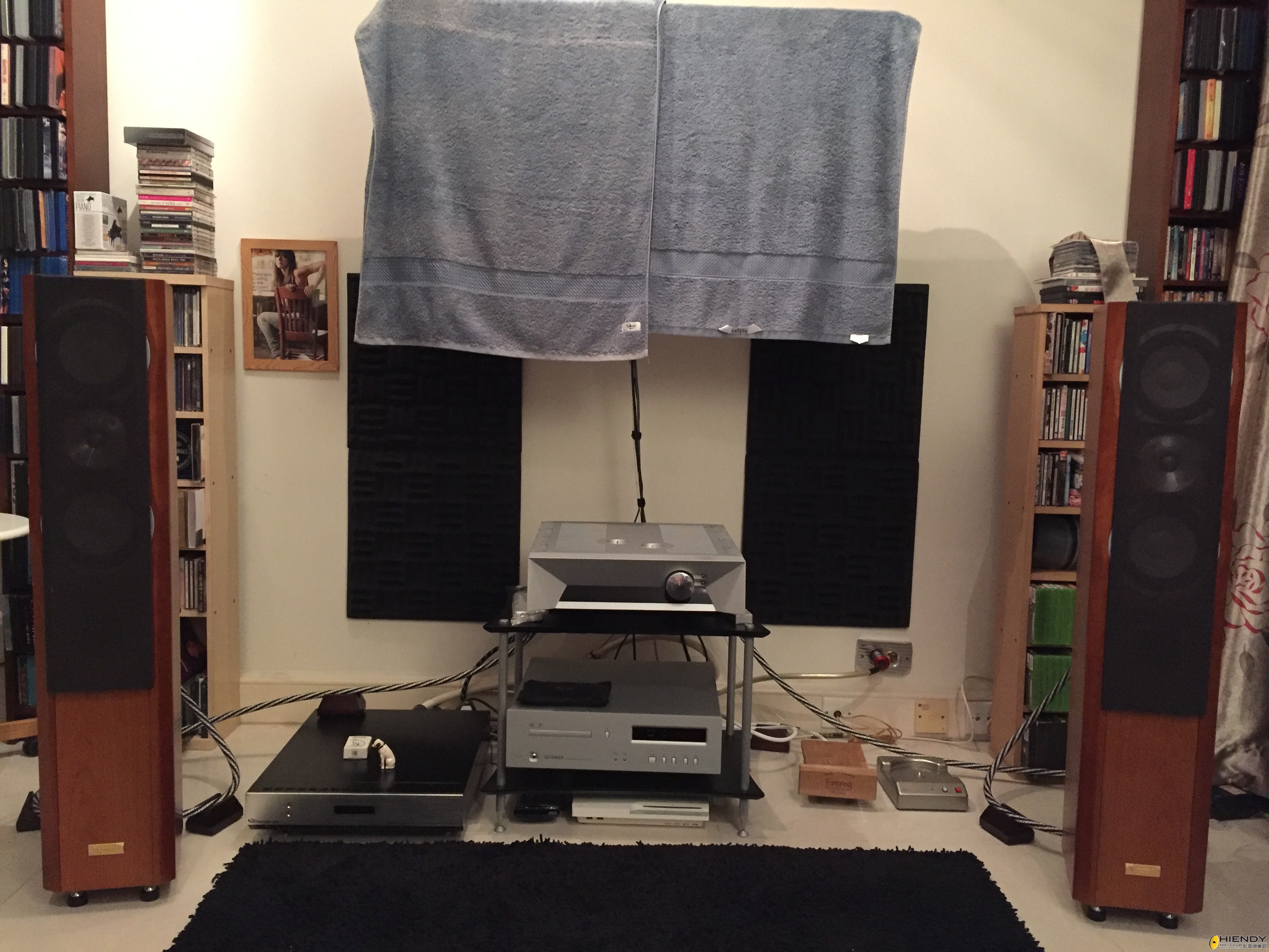

Yes, my wife didn't notice this Hifi related.
I have been testing with central 散聲板 as well.
This viscoutic panel, made of HD foam, flexible and lightweight. Can move around.
Combine with 牛肉粒 will be perfect!!
This works very well and aesthetically good!

Hi,
The one in front of the TV, is that from Auralex?
Thanks,
