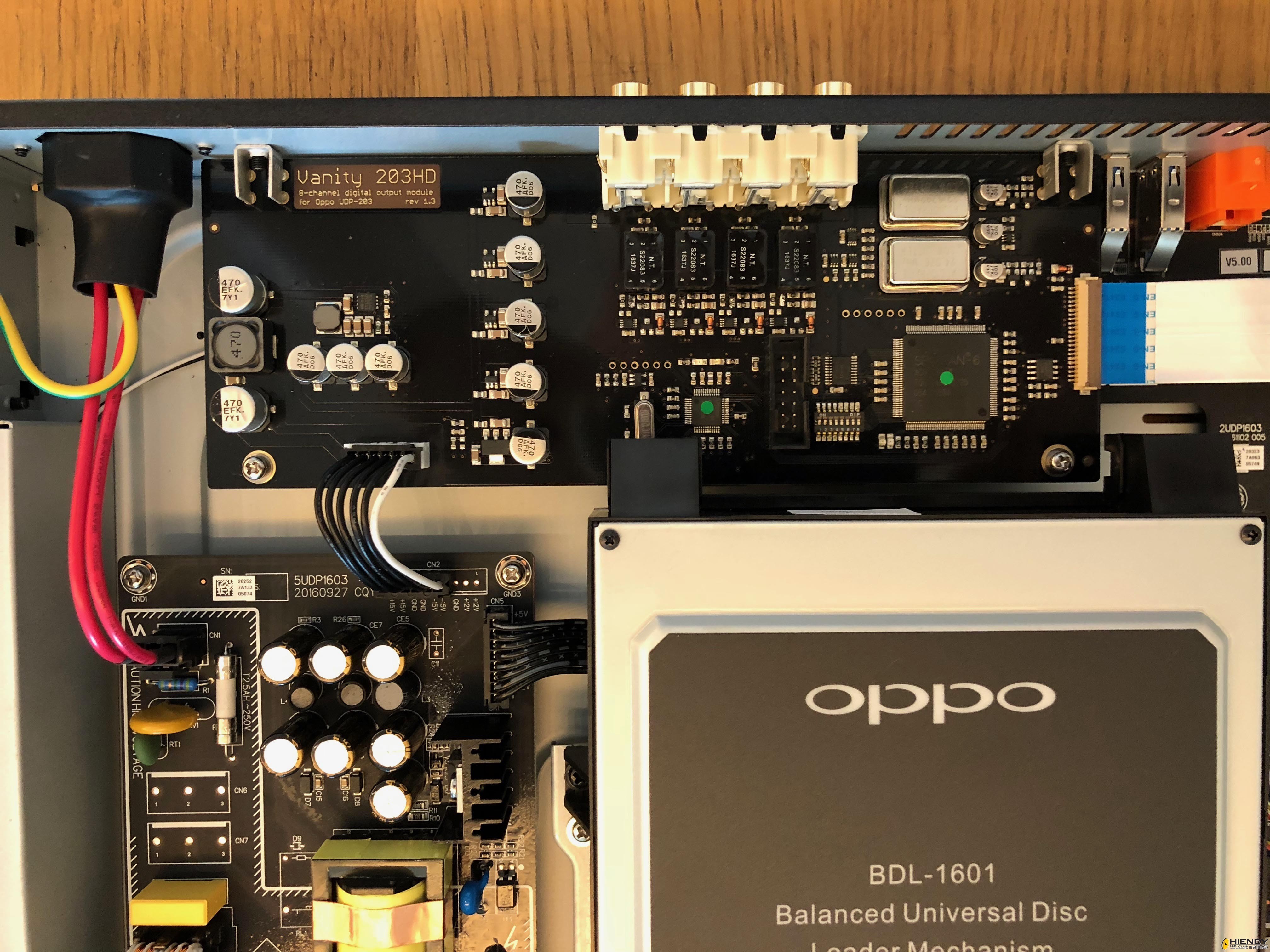

I saw many post here about modification of the PSU or even the analog circuit. But this mod is a bit different. It make used of the digital output board developed by Audiopraise.
http://audiopraise.com/vanityhd/overview.php
http://www.audiopraise.com/forum/list.php?13
Audiopraise has been doing digital mod for over 10 years from the original 93, 103 and now 203. Modification of the Oppo allows digital out in SPDIF or AES format. You can also modify further to allow I2S out.
I plan to connect the output to Minidsp DDRC-88D and 88BM
https://www.minidsp.com/products/dirac-series/ddrc-88d
This allow room correction and base management with Dirac Live processor further.
The digital output is finally output to 8 channel DAC of your choice. There are plenty available and I will be using. Metric Halo LIO-8
http://mhsecure.com/metric_halo/products/hardware/lio-8.html
Since OPPO can decode 7.1 signal. I will not need a AV processor and still get the best performance. For AV speaker, I will be using Genelec

Hi
Interesting post . finally someone have similar thoughts  . i m using 3 independant dac for decode. So did u try yet ?

師兄,這個玩意絕對可行,因我也正尋找合適的解碼中
 樓主| 發表於 2018-1-1 23:03:54 | 顯示全部樓層
Waiting for Minidsp DDRC-88D - will report back
發表於 2018-1-1 23:06:52 | 顯示全部樓層
Metric Halo LIO-8 as pre amp as well ?
 樓主| 發表於 2018-1-1 23:24:58 | 顯示全部樓層
Yes. With volume control
發表於 2018-1-2 00:08:27 | 顯示全部樓層
How does it sound?
 樓主| 發表於 2018-1-2 00:12:14 | 顯示全部樓層
Studio DAC very clean and dynamic
發表於 2018-1-2 12:21:28 | 顯示全部樓層
thats exactly what i feel

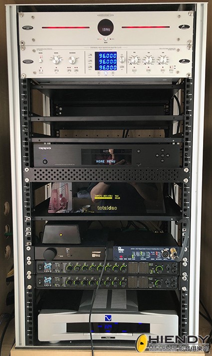

 樓主| 發表於 2018-12-30 17:43:37 | 顯示全部樓層
Finally updated my rack. My mod oppo 203 is now output to Mutec MC8.1 for sample rate conversion and aes3id to AES 3 conversion.
https://www.mutec-net.com/product_mc-8.php
The advantage is the all the source is now resampled to 96K for my DAC to be slaved to an external master clock
There is no need to change the clock frequency anymore
From Mutec to miniDSP DDRC 88BM
https://www.minidsp.com/products/dirac-series/ddrc-88bm
This allows state of the art bass management and dirac live for room correction for all 7.1 channels.
The AES output for DDRC is then output to ULN-8 for DAC which goes to my active speakers.
發表於 2018-12-30 21:18:21 | 顯示全部樓層
ackcheng 發表於 2018-12-30 17:43
Finally updated my rack. My mod oppo 203 is now output to Mutec MC8.1 for sample rate conversion a ...
師兄,見你用audio technology單元,果然識貨
