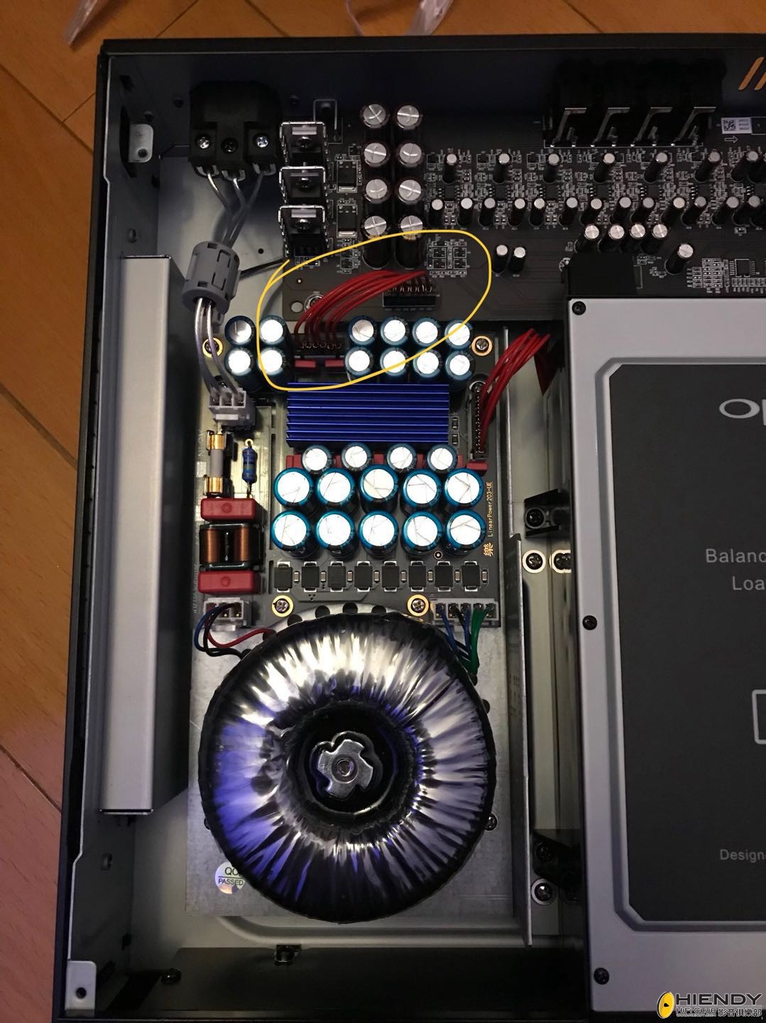

”removed the analogue PCB board” is that means to remove the circled pin?
發表於 2018-5-17 12:20:28 | 顯示全部樓層
hscar 發表於 2018-5-17 08:03
我用老虎魚,我系 remove the circled pin
發表於 2018-5-17 13:00:07 | 顯示全部樓層
Samson2011 發表於 2018-5-17 12:20
唔該師兄. 等我都試下先
Yeh. That's it. Also the flat cable on the right hand side. So that the whole board can take away.

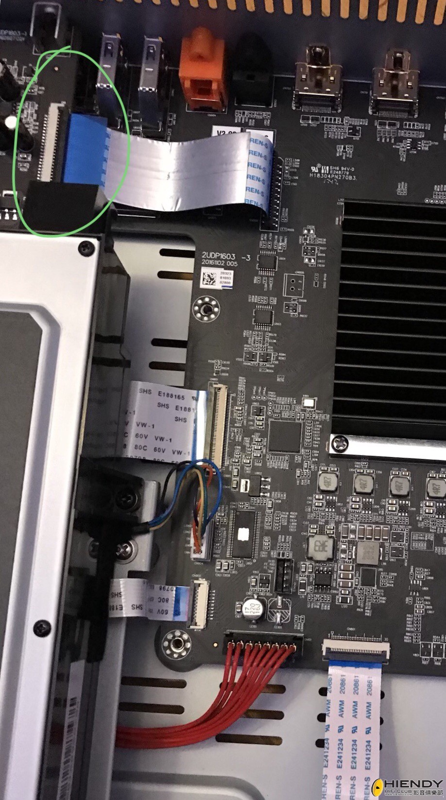

發表於 2018-5-17 15:40:07 | 顯示全部樓層
tune 發表於 2018-5-17 14:54
Yeh. That's it. Also the flat cable on the right hand side. So that the whole board can take away. ...
Do you mean the circled one on this pic?
