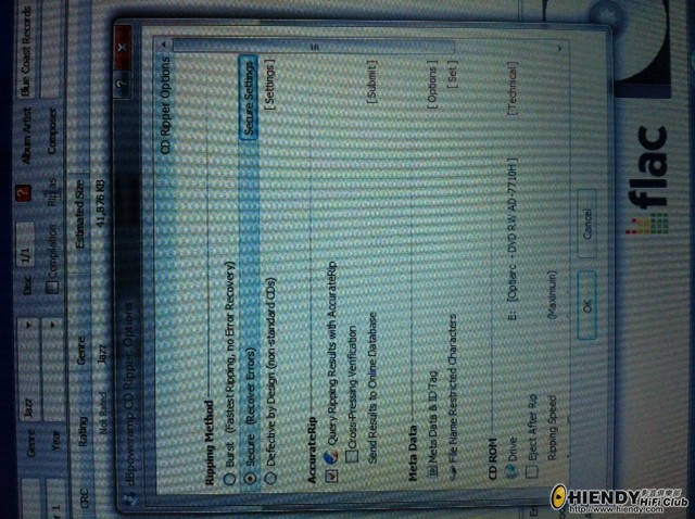

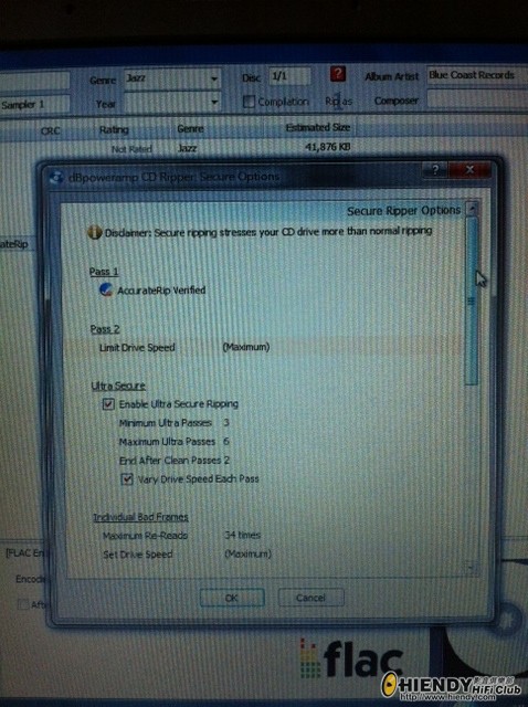

昨日買了 新電腦 預安裝了 window 7 後再裝回 dBpoweramp  但無法setting 到 rip CD 用Ultra Secure ,我在 secure setting 以 enable 了用 Ultra secure 和 very drive speed..

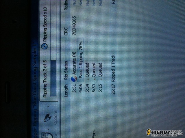

,之後在 Accurate Rip 也 enable 了 Query Ripping Results.. 現所有 rip 的碟 status 都是出 Accurate 不是 Ultra Secure ?? 請問各大師兄,應該如何setting 才對如要有 Ultra Secure status?
發表於 2011-5-12 11:50:39 | 顯示全部樓層
Ultra Secure status will only be shown if the CD-ROM need to rip the source several times (due to poor source).  In normal situation, if AR has record, only Secure will be shown.
 樓主| 發表於 2011-5-12 12:19:50 | 顯示全部樓層
thanks ! but it show accurate only after rip the CD !! so how can I do the setting if I want the Secure report ??

仲有, 有o的碟只會rip一次even you set secure mode.  It may due to the fact that the library does not have any reference or the other reasons. But I don't know!

Select "Log" under Option.

please find my setting copy....

I found the setting, but xp and window 7 rip status is different result...
