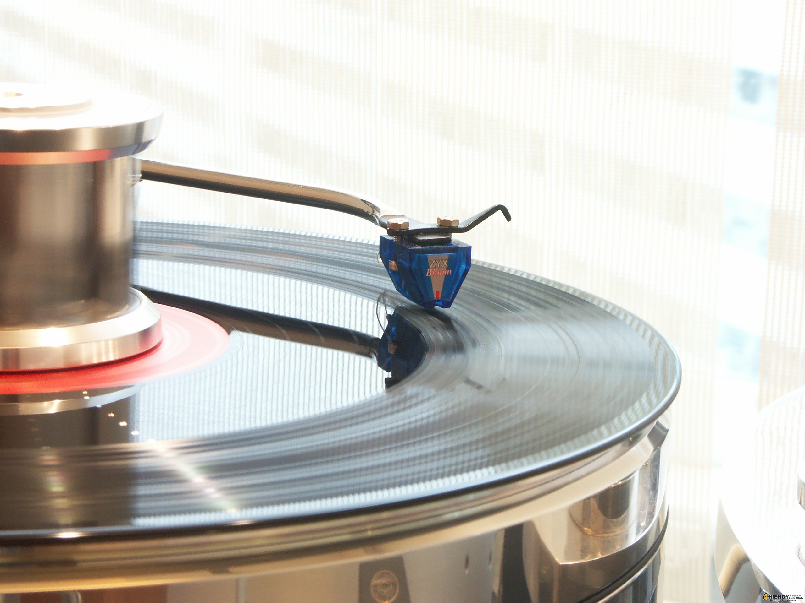

好低用的ZYX唱頭

這個唱頭日本賣63,000yen,表現係HKD7,000級唱頭
發表於 2011-5-24 18:23:32 | 顯示全部樓層
師兄,隻頭係低輸出或高輸出MC?
 樓主| 發表於 2011-5-24 18:27:38 | 顯示全部樓層
低輸出MC 0.2MV output 4ohm

這唱頭走新聲路線,動態好,高低頻去得盡,Jazz同中樂較佳,適合較年輕玩家。
bear6243 發表於 2011-5-24 18:27
What is the benefit of very low output at 0.2mV as compared to 0.5mV MC cartridge?  Would the phono gain need to be set to higher than 65 dB ?
發表於 2011-9-10 11:07:38 | 顯示全部樓層
本帖最後由 黃思璁 於 2011-9-10 11:17 編輯
回復 19# nagramen
Since phono cartridges are velocity transducers, we may put it this way:
3.54cm/sec denotes the velocity of the stylus at the middle of a vinyl record.
5.10cm/sec denotes the velocity of the stylus at the outermost groove of a record.
If an MC cart delivers an output of 0.24mV(3.54cm/sec 1kHz), that means, ceteris paribus, it may give you as high as 0.35mV at higher velocity(i.e. 5.10cm/sec 1 kHz).
If an MC cart delivers an output of 0.24mV(5.10cm/sec 1 kHz), that means, ceteris paribus, it can only give you as high as 0.17mV at lower velocity(3.54cm/sec 1 kHz).
FACT: HIGHER VELOCITY, HIGHER OUTPUT. LOWER VELOCITY, LOWER OUTPUT.
ZYX low output versions represent the former example. You may find the output "rather abundant" if you have a total MC gain of 60dB.
It is generally believed that the low output version of ZYXs offer better linearity, wider bandwidth, better transparency, better dynamics, better soundstage than its HIGH output versions.
