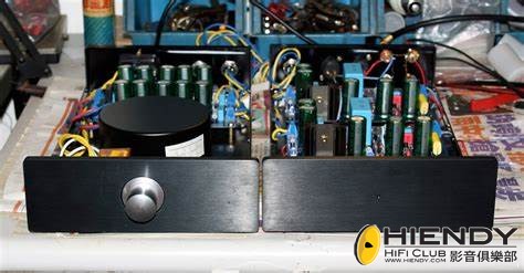

 樓主| 發表於 2022-6-11 04:48:17 | 顯示全部樓層
 樓主| 發表於 2022-6-11 04:48:53 | 顯示全部樓層
小弟用緊多年前的dz riaa phono
發表於 2022-6-11 13:10:36 | 顯示全部樓層
You use MM cartiage before? Seems there are no gain setting for your phono pre-amp...
If this is the case, you can only go for high output MC
