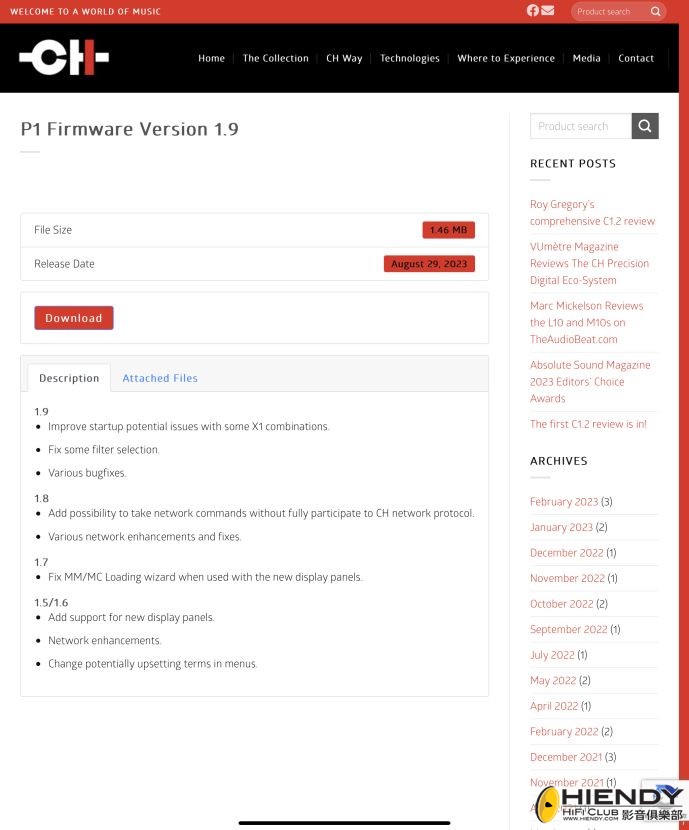

Any C Hing
Has succeeded to update the firmware for P1? I have tried, but the P1 prompt that no valid firmware in USB found. I have downloaded the zip file and unzipped it, but the update still failed. With reference to the manual, I found the files miss “ P1_xxx.oP1”, after I unzip the zip file.
Anyone could advise..
Thanks a lot.
Rollei

P.S. https://www.ch-precision.com/download/p1-firmware/
9.1 Preparing the USB Stick
* FAT32 formatted (not NTFS or exFAT)
* USB 2.0 Type A (not 3.0/3.1 Type A)
* Sandisk USB 2.0 Sticks are recommended

謝謝 ieskn96 C Hing 提醒,-定要用USB 2.0 加Fat32 format USB drive. 部P1 才認到那些file….

Seems like CH is fixing some major bugs relating to X1.  I don't have X1 but do have C/D/P1 so I need to update all three equipment.
FYI it's ok to transfer ALL the firmware files to one USB (just no folders) and use that single USB to update all the equipment (one at a time), so there's no need to update one equipment-erase files-transfer files-update the next equipment.
Just did that today and all went smoothly!
