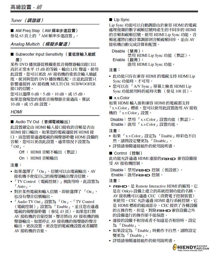

Onkyo AMP has a function "HDMI Control".  Try to disable it if it can help.

回復 3# hkbomberman
都係唔得
