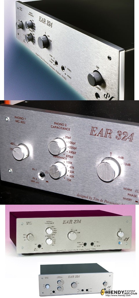

how about EAR 324?
i think the 2nd hand price may fit your budget

C兄你係第二個人向我推介佢,未聽過吾知音色但之前用佢細果隻好似係834p膽推覺得聲音比較慢和柔,咁324可能較全面會搵機會試試

在此價位,如師兄喜歡它的音色,324可以滿足好幾個願望

本帖最後由 nagramen 於 2011-7-16 00:24 編輯
Description: Solid-state phono preamplifier. Input impedance: switchable between 4 and 40 ohms (moving-coil), 15k and 100k ohms (moving-magnet).
Output impedance: 60 ohms.
Gain: 54dB maximum. Input sensitivity: 2.5mV (moving-magnet).
Signal/noise ratio: 68dB ref. 2.5mV input.
RIAA accuracy: <0.3dB.
Channel balance: <0.2dB. THD: 0.2%.
Dimensions: 12.7" W by 4" H by 10.5" D. Weight: 11 lbs.
Gain only at 54dB max. Is it a bit low for some MC cartridges??

我依家用緊部phono幾多增益都吾知噃,而家個mc頭出0.4mv都間中覺得有啲overload。
