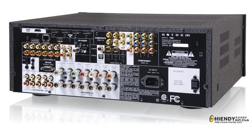

I'm planning to buy a Macbook pro 13" use as CAS. What is the most simple and quality way to connect Macbook to AVamp.
I'm using Anthem MRX 700 with USB input. can I simply use USB cable connect Macbook (keep using iTunes) to Anthem AVamp?
Please advise, appreciate :)
發表於 2011-9-4 23:07:06 | 顯示全部樓層
應該就唔得喇.. 據官網講:
7 channels, 120 watts per channel of continuous power, play music from a flash drive or USB hard disk drive, Internet radio, HD radio, 3D ready, Anthem MDX 1 Dock coming soon!
只可以插Harddisk入去. 佢自己有晒decoder去play. 唯有用部電腦Rip去wav file再copy去個removable usb hdd去play.

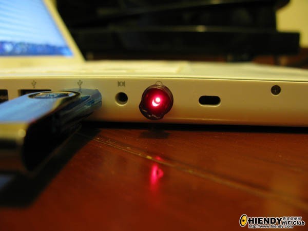

另一方法係用Macbook既optical output去部MRX 700. 咁就可以用itune去play.

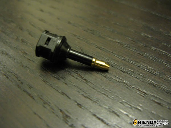

最主要買既係條Optica cable. 而Mac機要mini TOSlink , 可能要買多舊convertor:
至於聲音, 就真係要駁黎聽下先知. 不過用Mac機做source大有人在, 好聲與否並非Mac機本身. 所以買Macbook係無錯.   去左馬先. 呢度d師兄會有好多補品介紹點去整到好聲

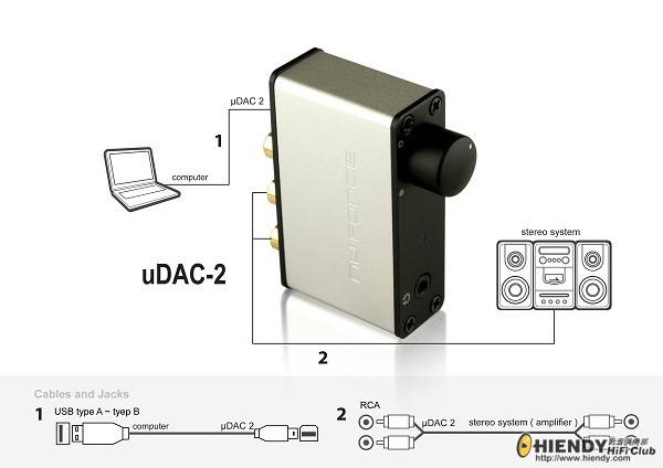

其實Optical呢個方法係最方便, 但係聲音表現當然無咁十全十美喇. 而其中一個比較簡單d既方法就係加舊USB解碼.即係正式入CAS之門. 平靚正有: NuForce Icon uDAC-2. $900 - $1,000左右. 咁乜book都可以播到歌.

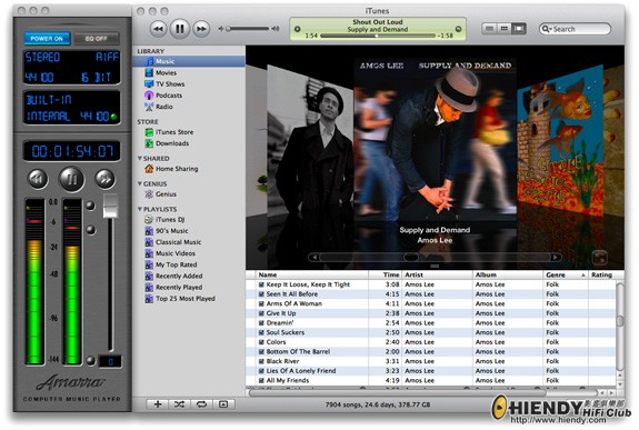

至於Mac定PC好. 其實無100%答案, 兩邊陣營都有唔同software去播高解像度既歌. 而Mac機會有隻software叫Amarra, 都係一種software去enhance輸出黎既音樂.
