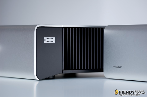

全新SOULUTION 501 MONO AMPLIFIER 將於2012 CES 登場
We proudly announce the next product of the soulution Series 5. The 501 mono amplifier will have its world premier at CES 2012 in Las Vegas. Come and convince yourself of the build and sonic qualities of this new member of the soulution product family (Venetian 29-139).
The 501 mono amplifier is a single ended design with a power rating of approx. 125W into 8 ohm. The peak power rating is well above 1kW and will drive any speaker on the mar-ket. Its sound characteristic is very similar to the highly esteemed virtues of the Series 7 amplifiers.
Power amplifier
The new power amplification circuit of the 501 is based on the technology used for amplifi-ers 700 and 710. This new voltage amplifier technology works without any feedback to the input (no differential amplification). It is built from linearised amplification units that run up to a frequency of 80 MHz.
The current amplification is done in three stages, each stage working in a narrow and lin-ear operating area. Its rather high class A operation mode combined with 47'000 F ca-pacitance leads to nearly unlimited impulse reproduction. Massive copper rails on the circuit board as well as to the binding posts ensure that all the power is really conveyed to the loudspeaker.
A highly precise idle-current regulation ensures optimal class A operation for all conditions without the necessity of any post control in the music signal. Best sonic performance will be available immediately and independent of the operating temperature of the amplifier.
Comprehensive safety functions ensure safe operation. The 501 Mono-amplifier is pro-tected against high frequency and DC signals at the inputs as well as against shortcuts in the output. Additionally the input level is permanently monitored.
Power supply
6 power supply units – each optimized for its specific function – provide the required sup-ply voltages. The power supply units supplying the control circuits of the 501 Mono-amplifier are perfectly decoupled from the power supply units of the amplifier section by galvanic isolation and opto-couplers.
Two switched mode power supply units with 1’200VA in combination with HighPerformance filters in the input and output of the power supply units provide supply voltages in audio-phile quality. Locally they get further controlled by 6 soulution high speed voltage regula-tors and are by far more stable than any traditional, trafo-based, power supply technology possibly could provide.
Production & Pricing
- The production starts in February 2012.
- Target retail price approx. CHF 36’000 per pair (for Switzerland)
Technical specifications:
Nominal voltage        100 - 120        V, 50-60 Hz
        220 - 240        V, 50-60 Hz
Nominal power rating        1’400        W
Standby consumption        <0.5        W
Input Impedance        10        kohm
Main-Out
Power rating Audio        125        W @ 8 ohm
        250        W @ 4 ohm
        500        W @ 2 ohm
Output current        45        A max
Amplification        +26        dB
Frequency response        DC-800        kHz
Slew rate        0.9        microsecond
Distortion (THD+N)        <0.001        %
Damping factor        >10’000
Signal to Noise (SNR)        >120        dB
LINK-IN        +12        V
Weight        ca. 22        kg
Dimensions:
