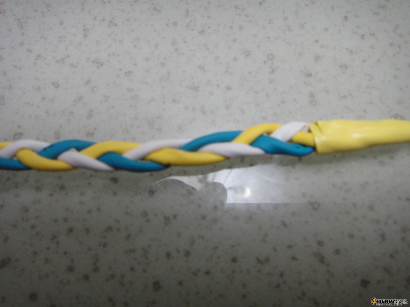

本帖最後由 1o1o 於 2012-3-7 20:54 編輯
Pure Silver 6N 99.999% no coating
isolated Coating
Cover Coating
Pure Silver packed with coating
Twisted three Pure Silver line
Both End Packed with Isolated Tape
a transparent Isolated Coating
Packed with Cover
Finished Product

 樓主| 發表於 2012-3-8 10:07:52 | 顯示全部樓層
本帖最後由 1o1o 於 2012-3-8 10:09 編輯
nagramen 發表於 2012-3-8 08:06
Congrad
But why do you use 3 wires? How do you connect them to the plug?
CHing 我總的做了四條,
二條只連接中間的 center pin connection。外面的 GROUND 沒連接。
二條的藍色 連接 center pin, 黃色跟白色 連接 GROUND (連接 PRE―AMP)
另一頭的 白色 沒接 GROUND (連接 PWR―AMP)

 樓主| 發表於 2012-3-8 12:08:21 | 顯示全部樓層
本帖最後由 1o1o 於 2012-3-8 12:11 編輯
tanjongaru 發表於 2012-3-8 11:46
二條只連接中間的 center pin connection。外面的 GROUND 沒連接。 ==> So you mean the 3 conductors al ...
==> So you mean the 3 conductors all connected to center pin?    ==> YES
match with this purpose
'Used on the back panels of specific gear they enable direct connection of Pre to Main Amplifier paths were the ground is already established internally.
The signal path is through the center pin connection, when a electrical path from shield to shield is not needed or to be avoided."
==> So you mean the 黃色 cable is connected to the ground pin of both RCA plug, this also mean both end (and the cable) are connected to ground. ==> YES
白色 is for shield use.
this two cable is for next test. I want to test both have any different result.
如果有錯誤連接,請指正。 我都是從網上看到的。
