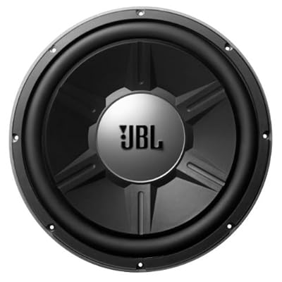

不知你原來的箱子用那種低音﹐圖片型號的18"超低音聽說口水不錯﹐分頻點在65-100HZ都可以認人滿意

JBL is not good for HIFI
http://www.amazon.com/JBL-GTO151 ... oofer/dp/B00269X90G
Rockford-Fosgate-T2D415-15-Inch is better
http://www.amazon.com/Rockford-F ... oofer/dp/B003KTPO6S
