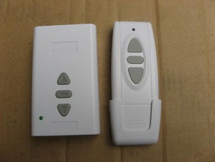

I bought this one in TB before at about RMB65. It come with 2 controllers, one is remote and the other is for you to fix on the wall. Normally you will use the remote control but if you lose the remote then you can still use the one on the wall.
Use the wording "投影幕遙控 " to search in TB la.
P.S. those selling at RMB3X come with one remote controller without the redundancy fixed controller.

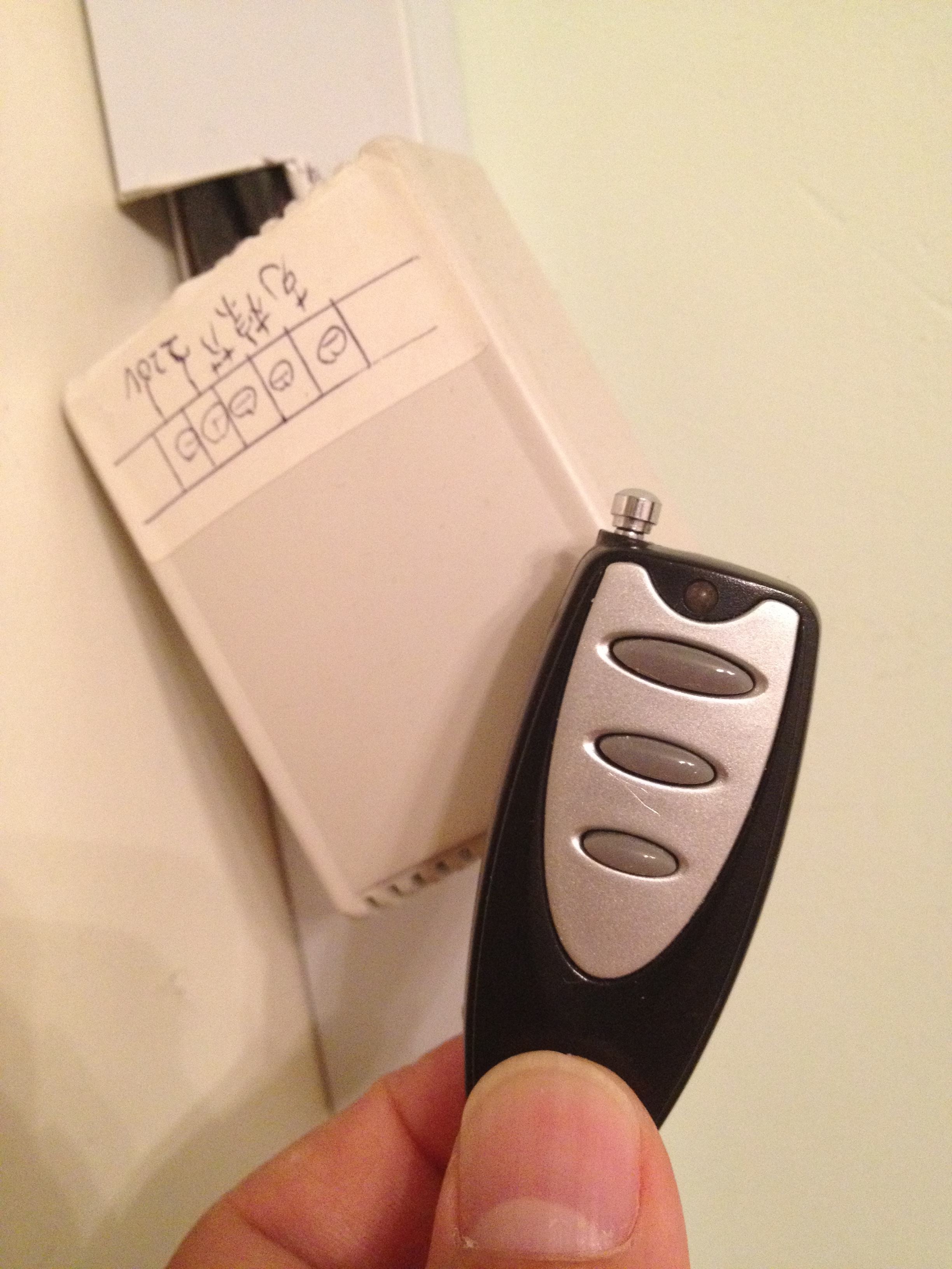

AS pepsiman said, you have to install yourselves or find a master to install it. The package comes with manual that you can follow.
Here is my work for your reference (but Stewart may have less wires), not that difficult!

大口師兄,
你個remote receiver power inlets L , N 好牙燕 ,
露左好多銅線,  好似好易short circuit
