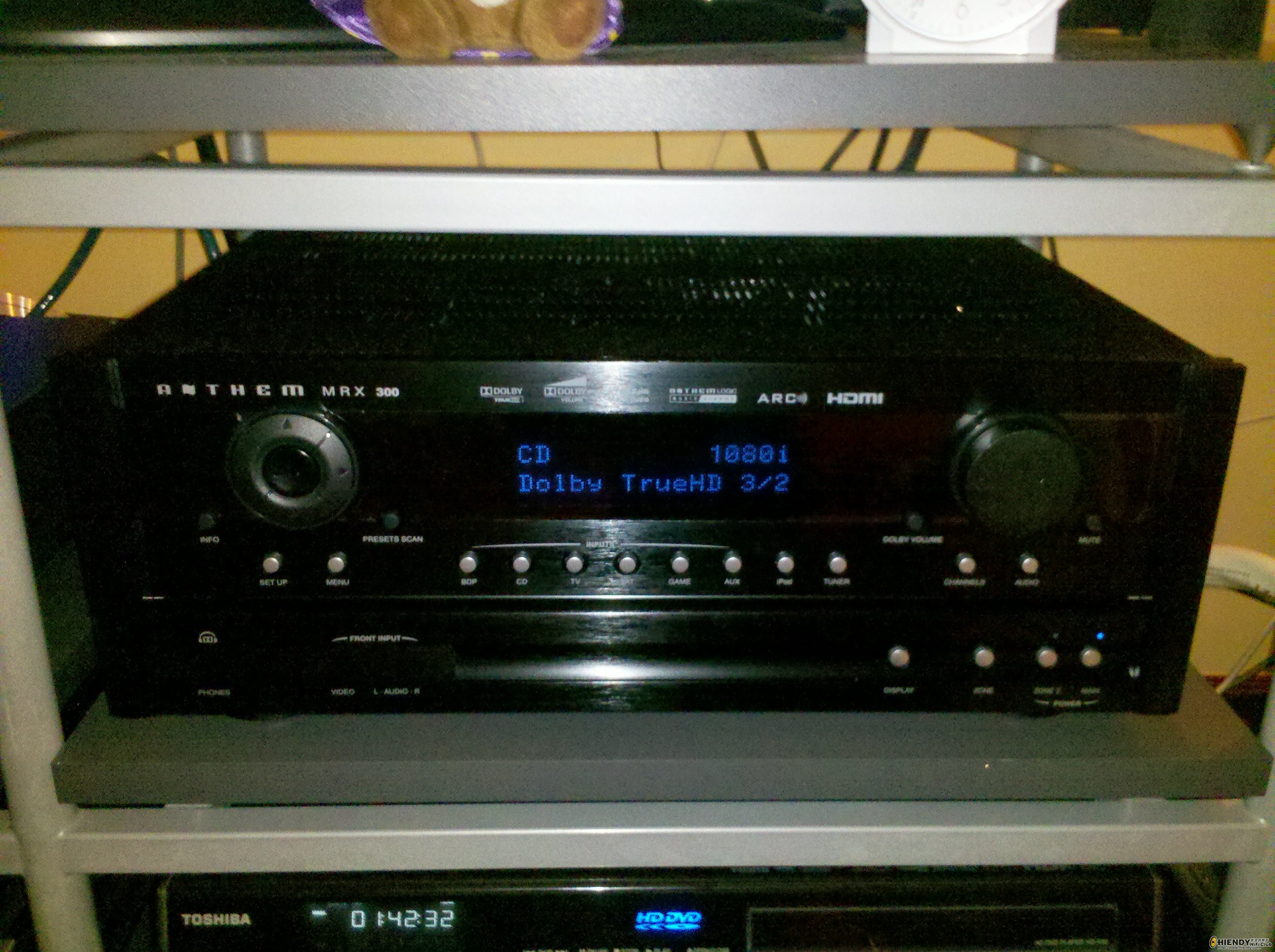

咁多位師兄,想請問一吓唔知點解個anthem 只出到1080I.
之前用integra 都無依個問題.
報告遲啲set 好機再上
Source: Denon Bluray Player
AV Amp: Anthem 300
Power amp: Parasound A52
Speaker: B&W Signature 805
Center:  B&W HTM4

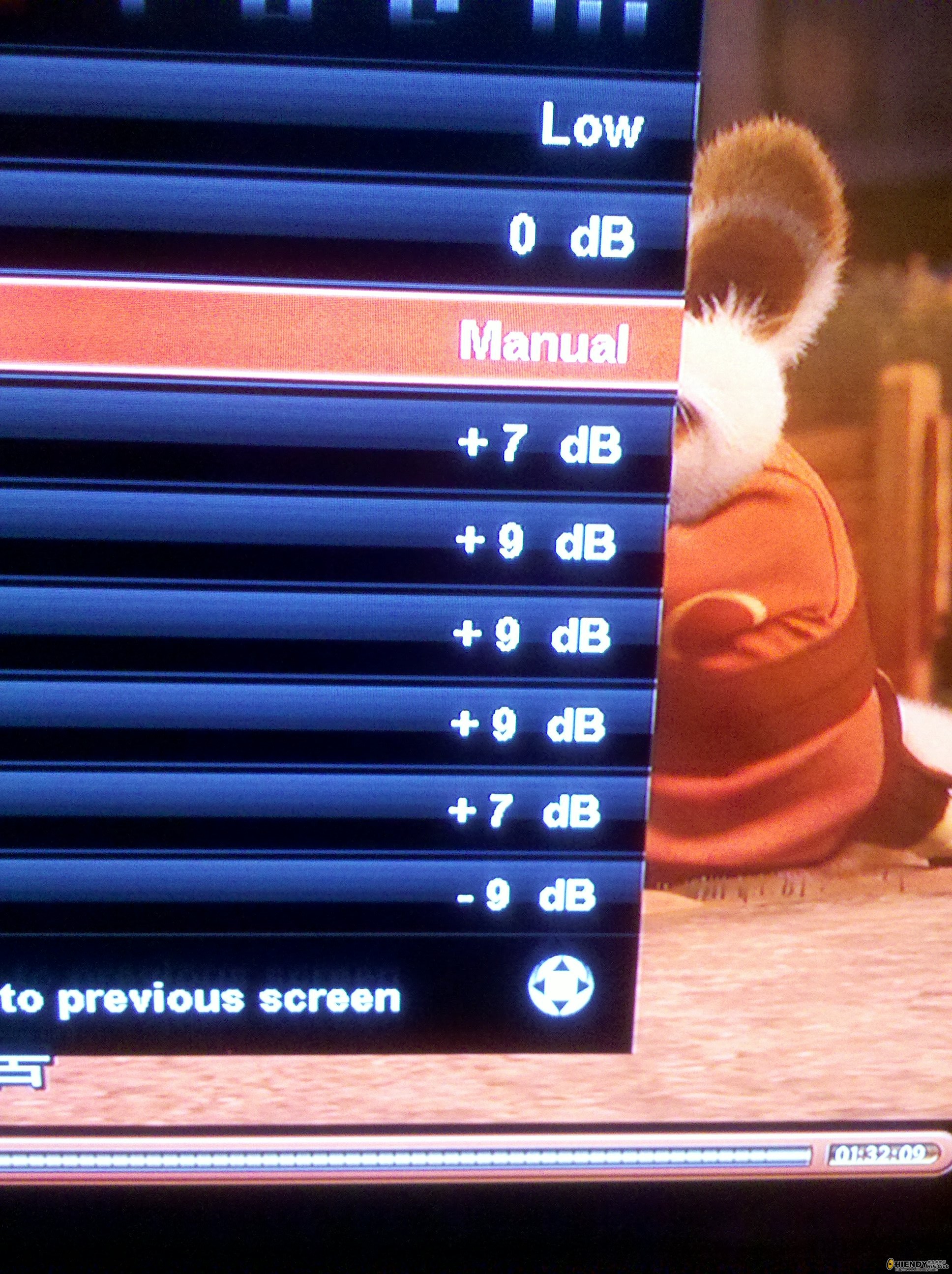

仲有行完個ARC,
個超低同其他Speaker 的level差好多

謝謝, 但唔知係未唔識SET, 出唔到1080P
1. 1080i problem, ensure MRX 300 set HDMI resolution to "Auto" and blu-ray player resolution set to "1080P"
2. subwoofer level problem, it's normal. Don't worry. Not below -10 or above +10 then acceptable.
cheers~

1080i was the input resolution, not output, it is showing the source resolution, press INFO button to toggle and you will understand.
Turn down your subwoofer level by 9db and recalibrate all again, try to get +/-3db in subwoofer level after calibration.

1. 1080i problem, ensure MRX 300 set HDMI resolution to "Auto" and blu-ray player resolution set t ...
Thanks Ching,
player同anthem都已Set auto,
今日上咗別蕉問,
叫我試吓factory restore,
因已試過用唔同的player都只係出1080i
如果都係唔得就聽日般返去俾別蕉睇睇

If your bd player resolution set to "auto", then it will output original video source signal to MRX directly. So I think your video playback original resolution is 1080i, then your MRX would output 1080i only.

Thanks for your advise , but I can confirmed that my player can output 1080p which I have tested by my old integra amp. Futhermore, I have tested the MRX 300 with UD8004, HD-DVD, PS3 both unable project 1080p.

although all your players "can" output 1080P, but did you actually somehow "set" it to output 1080P24-fixed?   It is mostly the players setup issue to me, you won't be glad if eventually find out its actually the player's setting after you bring a 36lbs. machine back to shop.

Just fixed, finally found out it was the problem with the HDMI
BTW, I have recalibrated all the channel, but found out the bass is not quite enough. Shall I increase the level or wait until the machine to burn in first?
發表於 2012-7-16 02:11:53 | 顯示全部樓層
you may want to screen capture the ARC charts, post it like others did and we will take it from there:
http://www.hiendy.com/hififorum/ ... page%3D4&page=7

For ARC charts interpretation, I think grandetech  is a very helpful hand.
