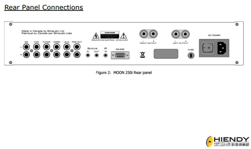

 樓主| 發表於 2012-7-30 09:56:20 | 顯示全部樓層
Marksix 發表於 2012-7-30 01:52
如果你部機有main in, 可做純後級就冇問題. 如果唔係, 就唔係咁好喇.
不過6/F試機佢會係咁不停吹到自己既機 ...
師兄們, 小弟唔係好識, 下圖為rear panel, 唔知做唔做到後級呢?
rear panel
rear panel

發表於 2012-7-30 10:05:44 | 顯示全部樓層
wilsonwong2 發表於 2012-7-30 09:56
無main in喎.
發表於 2012-7-30 10:06:29 | 顯示全部樓層
Should not support, according to this photo, it only support "pre-out", no "main-in"

發表於 2012-7-30 10:07:40 | 顯示全部樓層
你部合併机做唔倒後級!
發表於 2012-7-30 10:07:57 | 顯示全部樓層
obee 發表於 2012-7-30 10:06
yes la, 所以樓主可以唔駛諗upgrade了.
如果真係要upgrade部amp, 就要賣左部int. amp先. 再入手前後級了.
發表於 2012-7-30 10:08:19 | 顯示全部樓層
"pre-out" means the int. amp only act as pre amp (with input selector, volume control, output signal not able enough power to drive passive speakers)
"main-in" means the int. amp only act as power amp (no input selector, no volume control, just amplify signal to be able to drive passive speakers)

 樓主| 發表於 2012-7-30 10:22:04 | 顯示全部樓層
obee 發表於 2012-7-30 10:08
"pre-out" means the int. amp only act as pre amp (with input selector, volume control, output signal ...
感謝多位師兄指教!
真失望,想學人玩下膽機都唔得。
唔知搵部膽後級又得唔得呢?
