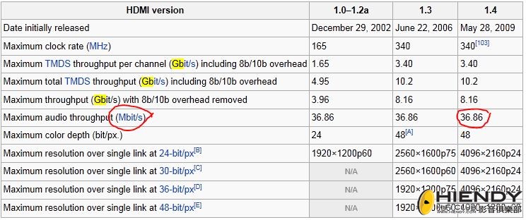

“音,頻,專,用“ must be 100% audio and 0% video? How about 90% audio and 10% video? (or 80% and 20%)
As you can see the picture above, audio throughput is 36.86 Mbit/s but HDMI can throughput 8.16 Gbit/s. Why audio need to use 100% throughput even it uses less than 1%?
