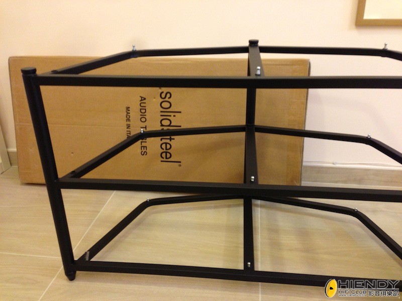

First box in 2013 and first time with SolidSteel.
SolidSteel H6
SolidSteel H6

記得睇manuel, 留意每層果三粒[向上既圓釘]點樣set法.

點解我上次開箱果時揾極都揾唔到嘅 都唔知有冇裝錯tim
簡單D講, 當你用鋁釘墊起塊板後, 再用六角匙慢慢扭幾粒[向上的圓釘], 直至[剛剛]接觸到塊板為止.
你果個H6三層共九粒圓釘. 你慢慢玩啦.

請問樓主張相是否已經是完成品?(因好似沒有層板)
 樓主| 發表於 2013-2-25 13:35:41 | 顯示全部樓層
未完成,後面個盒就係D板。因屋內仲有野攪,唔砌住。

racewong 發表於 2013-2-25 11:41
你果個 ...
真係裝錯左tim,我以為果九粒圓釘係裝飾!

好多人都似為係裝飾, 所以見有師兄出POST, 咪提一提佢囉.

果九粒圓釘應該有 damping 作用

Steps to setup (extracted from internet):
I simply had to install the spike feet on the bottom of the frame, set the duraluminium cones in their sockets and position the shelves. I installed the three decoupling screws for each shelf by tightening them with the included wrench until they just touched the underside of the shelf. That was all there was to it. I placed my components on the shelves, recalibrated the decoupling screws as necessary, and I was ready to go.
