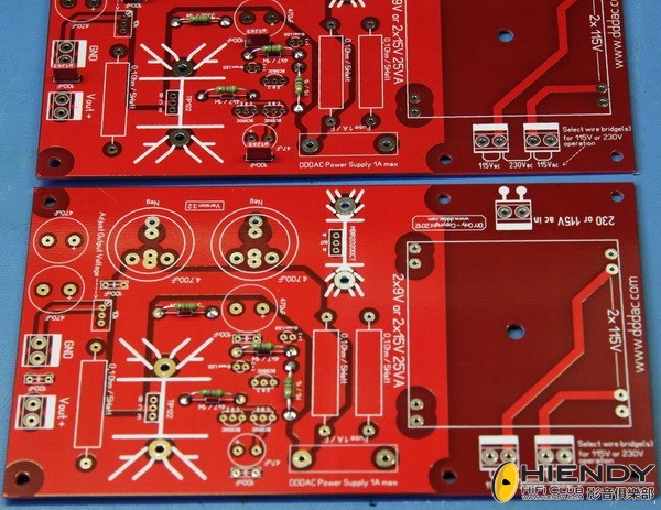

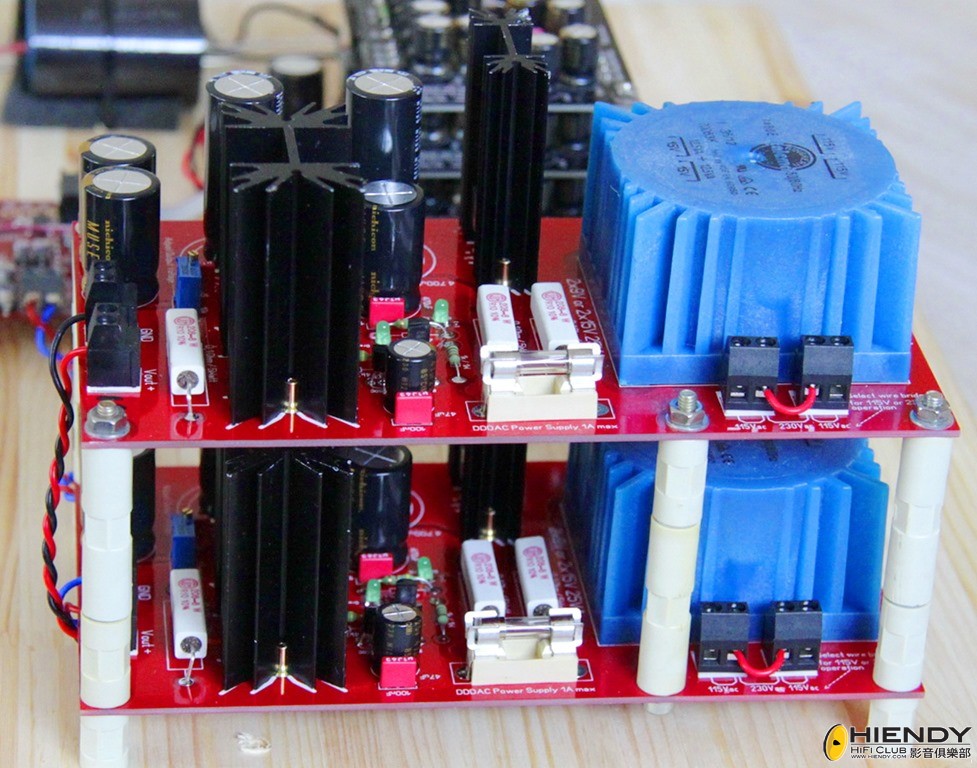

If not using Amplimo toroidal transformer, can D.I.Y. the power supply too.

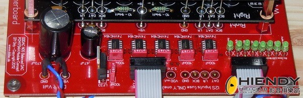

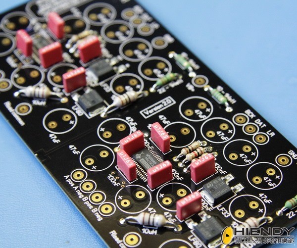

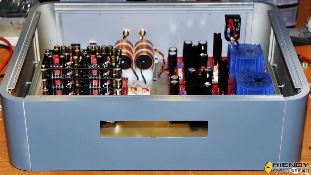

Now add the case...

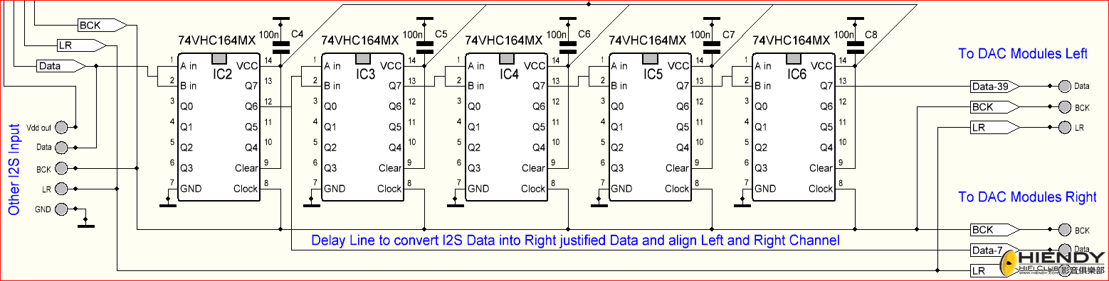

usb input is using I2S for the DAC - best connection at the moment
take away the two cap, and you can convert the output to - balanced
