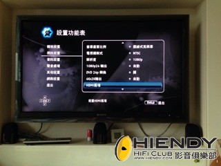

http://m.youtube.com/watch?v=6EtbbQSg8tk&feature=youtube_gdata_player&desktop_uri=%2Fwatch%3Fv%3D6EtbbQSg8tk%26feature%3Dyoutube_gdata_player
或者可唔可以幫我睇下咩事?

睇下...103個Hdmi out  setting是不是正確?

同意 , 好大可能 103 set hdmi output format 錯左, 所以出唔到 HD sound

請問有無set錯⋯

是set hdmi 的音效输出!
