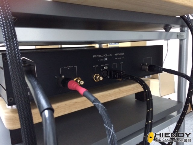

 樓主| 發表於 2014-3-1 23:37:26 | 顯示全部樓層
Picture taken today.  WaveDream together with W4S DAC2 DSD SE.  I have also taken picture of the back of WaveDream DAC
 樓主| 發表於 2014-3-2 19:11:43 | 顯示全部樓層
You can see at the back, the digital input includes SPDIF Coaxial, AES/XLR, HD-Link (Differential I2S on HDMI cable standard) x 2 and USB.
I'm using HD-Link all the time.  Using the battery powered Hydra-X+ driving WaveDream DAC is having very organic sound.  The HDMI cable I use is PS Audio AC-12 Silver HDMI cable.
