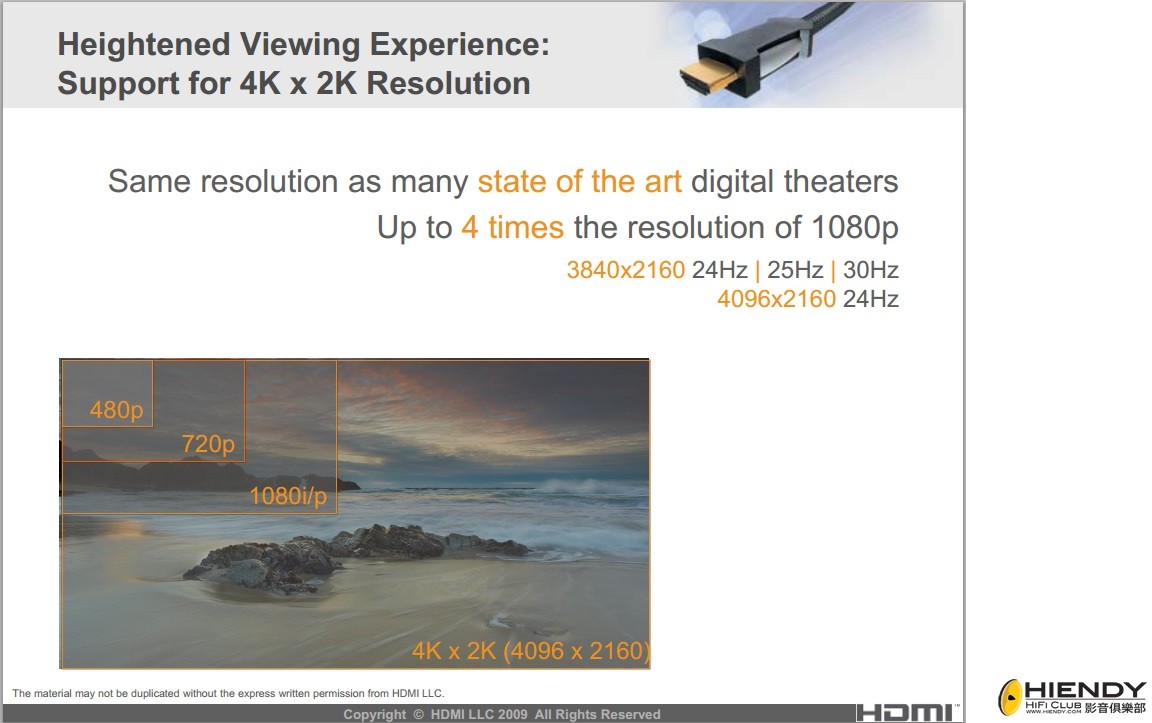

Yuppi hing,
HDMI.org. is confusing,
Your 1st link will lead you to High Speed hdmi (i.e. hdmi 1.4 standard)
If you look into details then you will find
hdmi 1.4 does support 4K as
3840x2160 (24Hz | 25Hz | 30Hz)
4096x2160(24Hz)
http://www.hdmi.org/download/pre ... 1_4_Final_083109.pd
hdmi 1.4
hdmi 1.4
In your 2nd link, hdmi.org states:
Can existing HDMI cables support the higher bandwidths of HDMI 2.0 Specification?
Yes, existing High Speed HDMI Cables (wire only) will support the new higher bandwidths (up to 18Gbps).
If hdmi 1.4 can support 4K 60P, what is the purpose of introducing hdmi 2.0?

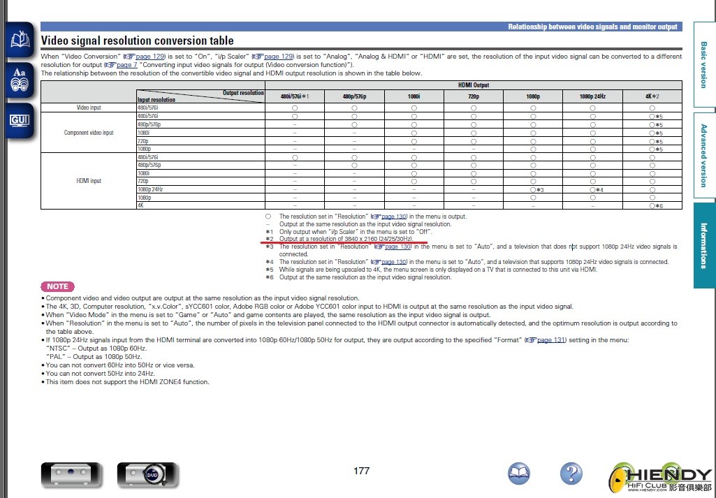

發表於 2014-4-22 14:43:31 | 顯示全部樓層
本帖最後由 ilccmcf 於 2014-4-22 14:49 編輯
實質上會有出入
小心
好似早前我介紹既德國4星..... 盒面上都寫明支援 4K
到打真軍之時..... 都係慘死..... 最後都要買過怪獸4K HDMI 先成事
http://www.hiendy.com/hififorum/ ... hread&tid=68775
真實播放都係要用電腦先出到4K
留意上圖 8801 係食到 4096/30
 樓主| 發表於 2014-4-22 15:24:49 | 顯示全部樓層
ilccmcf 發表於 2014-4-22 14:43
實質上會有出入
小心
我只知Marantz AV8801 4K upscale output 只係max. 3840 x 2160 30P,
Oh....原來 8801 食到 4096/30
