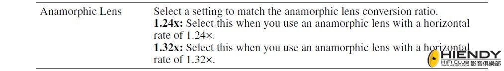

 樓主| 發表於 2014-5-15 10:38:27 | 顯示全部樓層
ccscho 發表於 2014-5-15 01:28
If the source is already cropped to 16:9, there is already no point to use the anamorphic lens to ch ...
ccscho兄,
以下是500ES的說明書其中一項內容
所以我相信anamorphic lens普不old age
發表於 2014-5-15 10:51:28 | 顯示全部樓層
