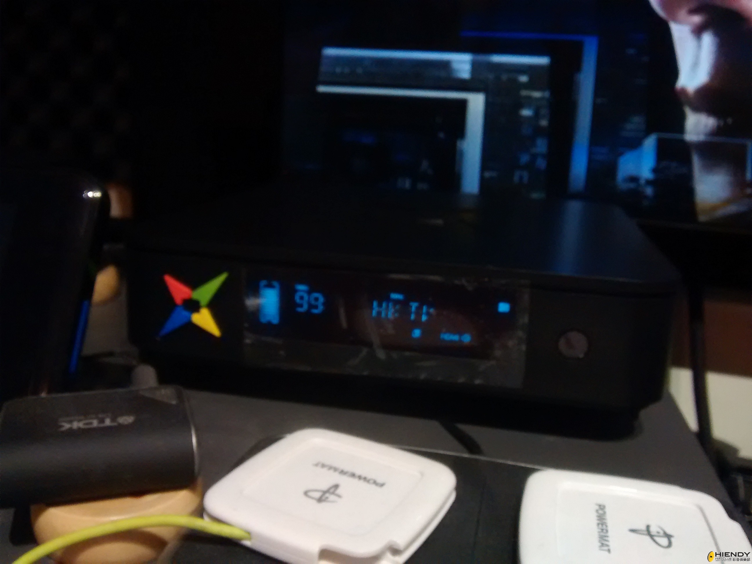

下午去科技园trade in部3300D,回家駁線后如常播放,多左個99台HKTV, 但黑仔的我部新机突然冇左其他台訊號,更换廳另一边天線再搜台后正常,但放回hifi主電視又冇天線訊号,得番#99台但pioneer tv天線訊号正常....
 樓主| 發表於 2014-11-19 23:40:20 | 顯示全部樓層
本帖最後由 rklpoon 於 2014-11-19 23:43 編輯
May have found the root cause.of MTV problem. Previously using t-joint splitter for main tv antenna in, one goes to front mtv/pioneer tv, other one goes to back side sony tv. Tv signal may be somehow diluted under this arrangement. Now not using the t-joint splitter(hence back side sony tv no antenna signal), the mtv has enough signal.strength and hence all tv stations come back as before.

rklpoon 發表於 2014-11-19 23:40
May have found the root cause.of MTV problem. Previously using t-joint splitter for main tv antenna  ...
Found this solution cause my brother-in-law has similar problem many years ago; ended up buying a tv signal boaster but only helped a bit...
