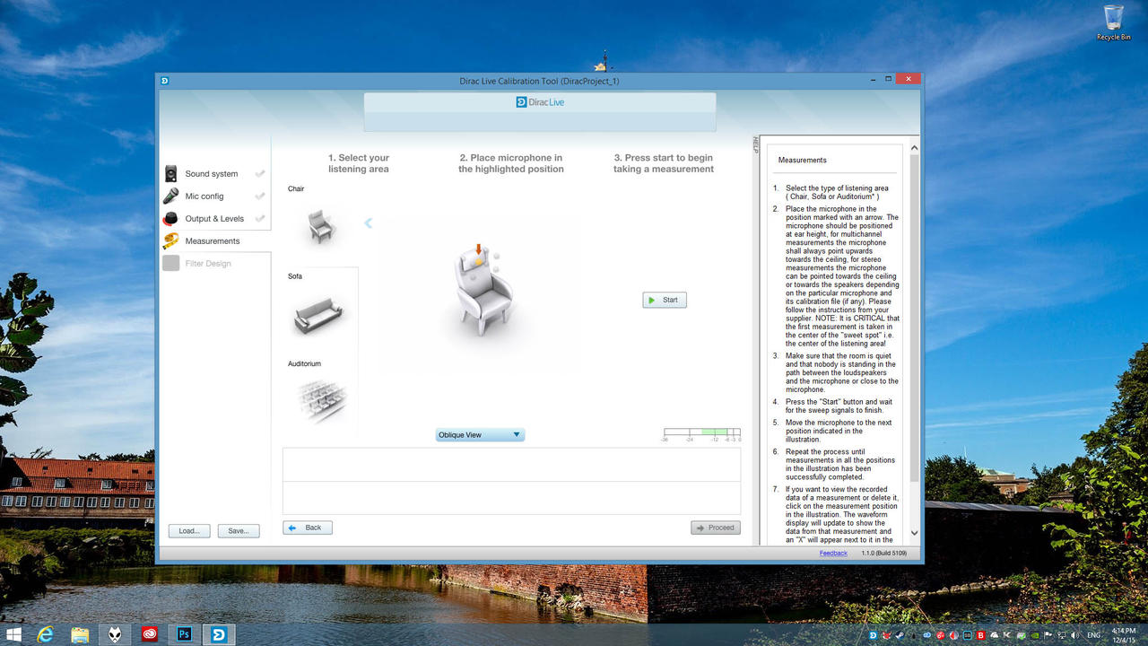

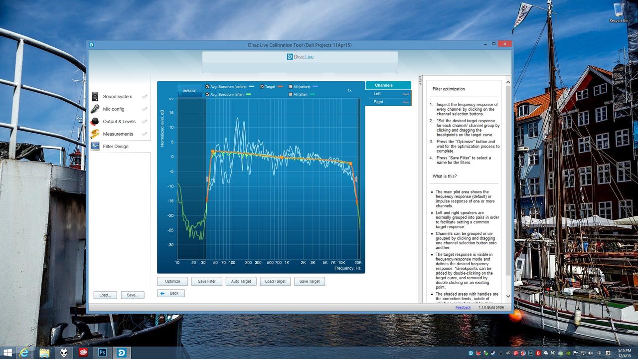

硬件上,好多人都討論到。但軟件上就少討論,有都係player或者rip軟件多。最近無意間找到一隻Dirac改善房間效應嘅軟件,因我套Hifi係放睡房書枱上,於是就登記Download試用版,另外再訂咗支全方向測試Mic。其實隻軟件要成HK$3247… 所以先分享一下,再睇下大家對呢隻軟件有咩睇法
1)當然先要去到呢度登記同Download試用版︰http://www.dirac.se/en/online-store.aspx

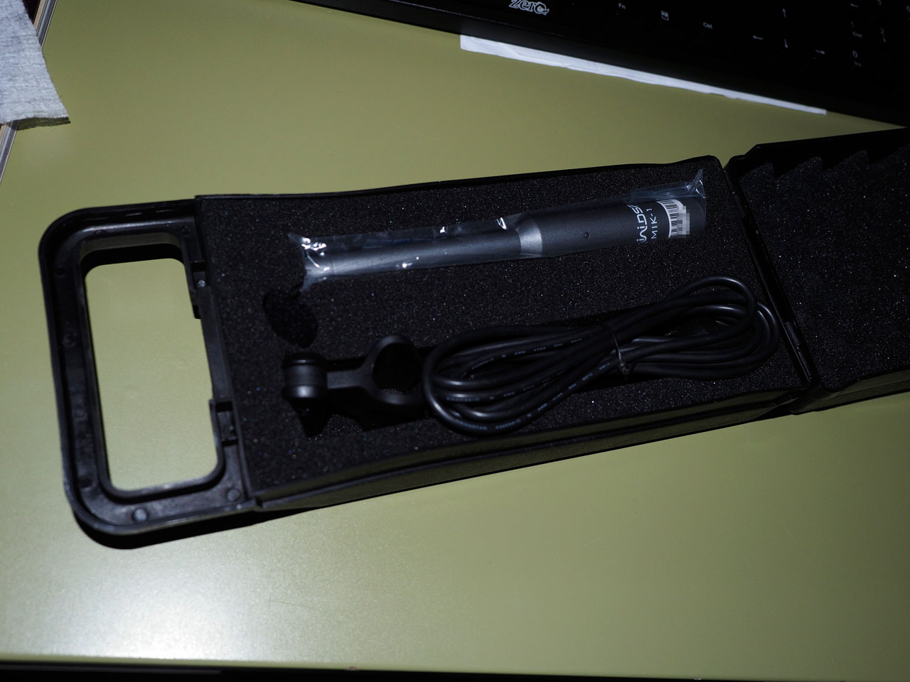

2)之後再買支Mic,唔係好貴,幾舊水

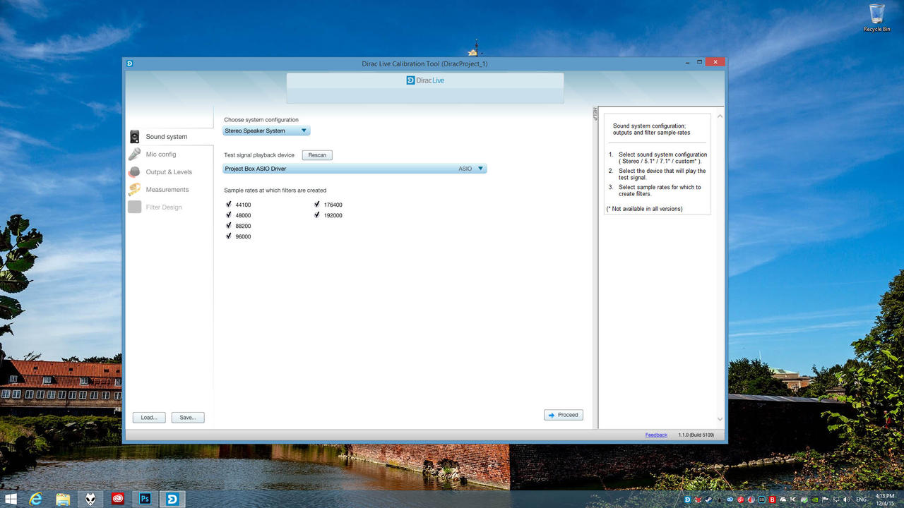

3)駁好Mic再開Dirac Live Calibration Tool,先選想調教嘅USB Dac或者sound card

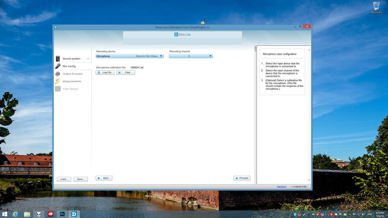

4)Set Mic同load calibration file

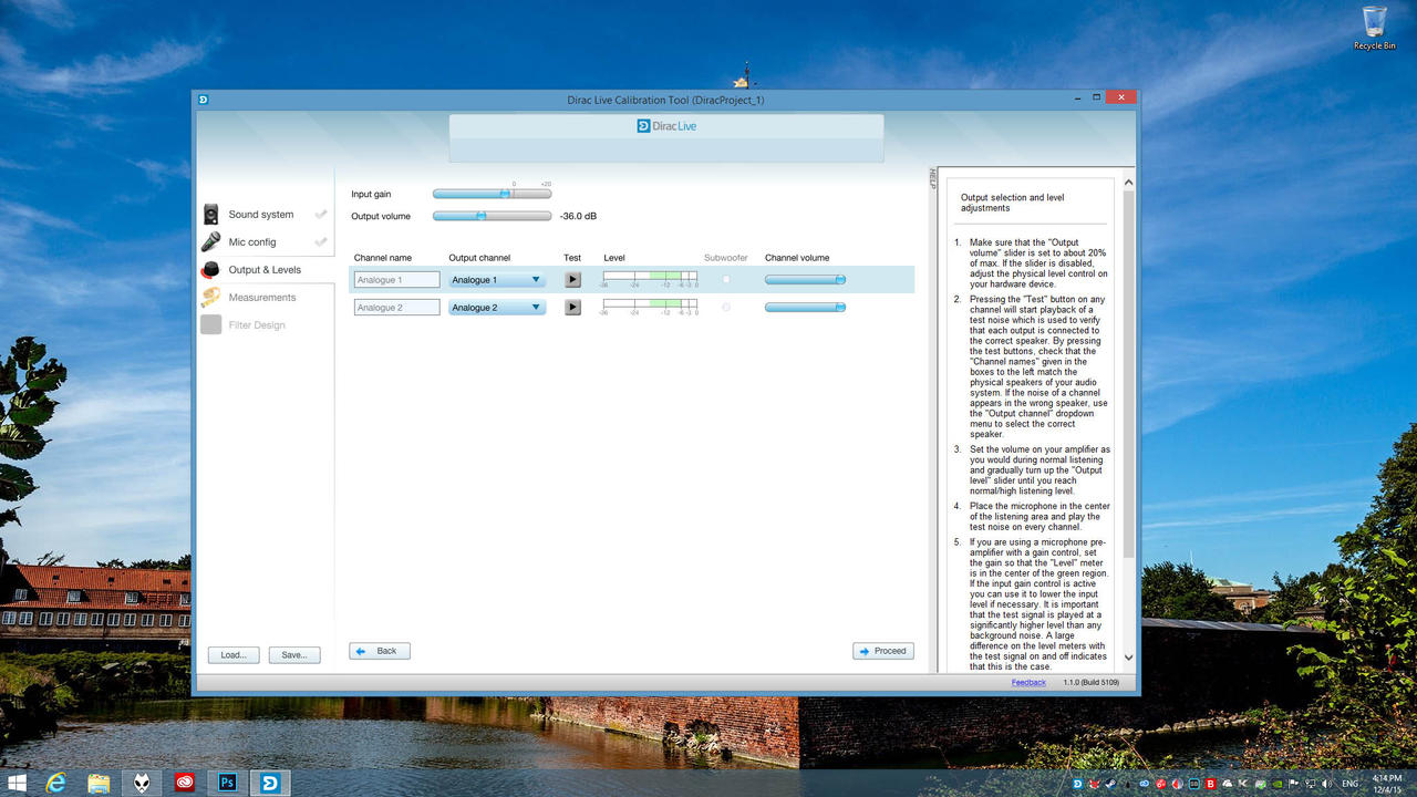

5)教Volumn同試下收音
6)好,選房間大細,我當然揀chair,之後就依指示開始在9點測音
7)測完音就可以按Optimize再save filter,當然亦可manual自己黎,不過唔識亦費事煩

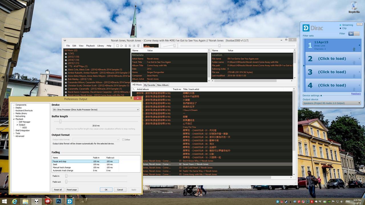

8)之後開Dirac Audio Processor,再load save好嘅filter同選好dac。再到Foobar 選Dirac playback device就可以播歌
一開聲,心就沉一沉,細聲咗咁多… 之後再由9點開大聲D到11點再聽,發覺音場冇變,detail咗dd,人聲或者樂器聲分隔度又高咗D,整個結像又好咗D。不過成HK$3247… 對我呢個窮鬼黎講都15/16,唔知好冇買咗佢… 大家又點睇呢?

師兄,支mic係咪USB? 邊處有得賣?
 樓主| 發表於 2015-4-13 23:49:18 | 顯示全部樓層
 樓主| 發表於 2015-4-13 23:51:19 | 顯示全部樓層
Crymen 發表於 2015-4-13 18:49
check pm please~

I use the built-in DIRAC in Amarra.  I found the default flat curve resulted in losing details in mid and high region.  So at the end, I just fiddled the low frequency region, say under 100Hz.
I think the mic is from MiniDSP (I bought from them also), a HK company.
http://www.minidsp.com/products/acoustic-measurement/umik-1

I use the built-in DIRAC in Amarra.  I found the default flat curve resulted in losing details in mi ...
"default flat curve"? you mean automatic "Optimize"?  I only know that the software will optimize the curve for us after measurement.  At the first trial, I flipped the left & right during measurement Haha, did you flip the left & right measurement points as well?
發表於 2015-4-15 18:39:32 | 顯示全部樓層
Pro-3 發表於 2015-4-15 12:00
"default flat curve"? you mean automatic "Optimize"?  I only know that the software will optimize  ...
Yes, "default flat curve" means automatic optimise.  No. I don't think I flipped right and left during measurement.
My problem then was bass a little too much and after measurement, it showed there was a peak at 60Hz in +10dB.  After trial and error, I settled at +4dB.

個config file support 咩野player?
 樓主| 發表於 2015-4-20 23:13:52 | 顯示全部樓層
elo 發表於 2015-4-15 18:39
Yes, "default flat curve" means automatic optimise.  No. I don't think I flipped right and left du ...
If the Dirac is not beneficial to your system, can u disable Dirac in Amarra?
 樓主| 發表於 2015-4-20 23:19:19 | 顯示全部樓層
karsonkwan 發表於 2015-4-17 01:58
Dirac 話所有player 都用到,因當你開咗Dirac Audio Processor之後係會多咗個Dirac Playback device出黎,你set佢做default device就可以了。我就只用foobar,完全冇問題。
