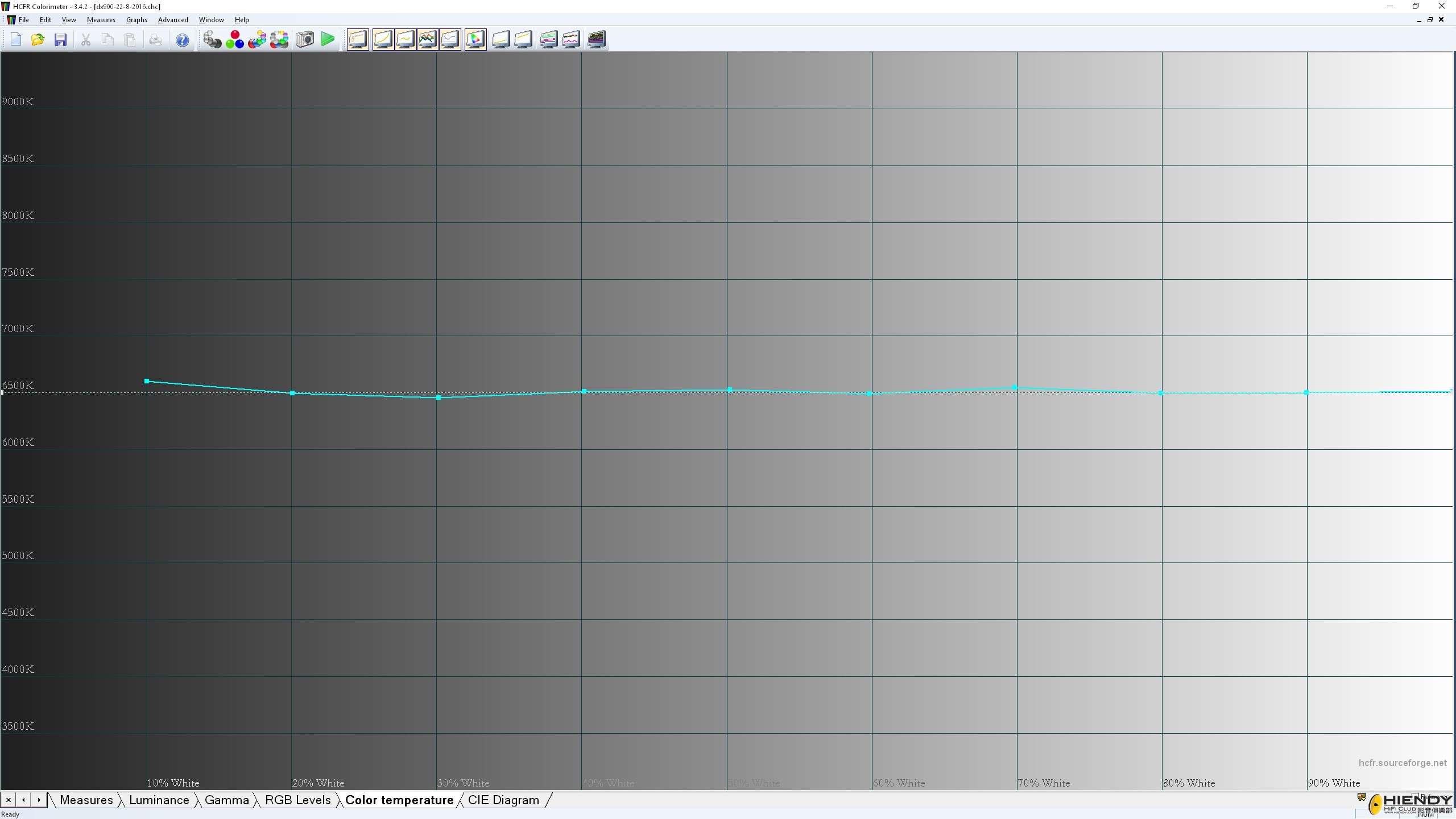

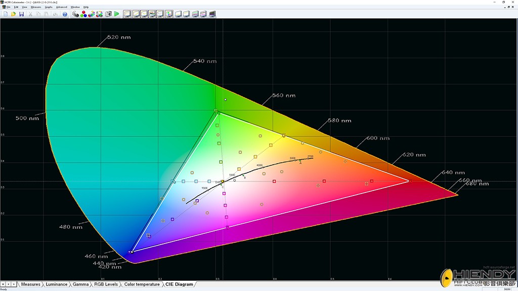

Finally , my Dx900 has been over 100 hrs operation, so i can has a first calibration of DX-900 by HCRF with X-Rite i1Display Pro . The attached pictures are result of HCRF calibration software about my DX-900.

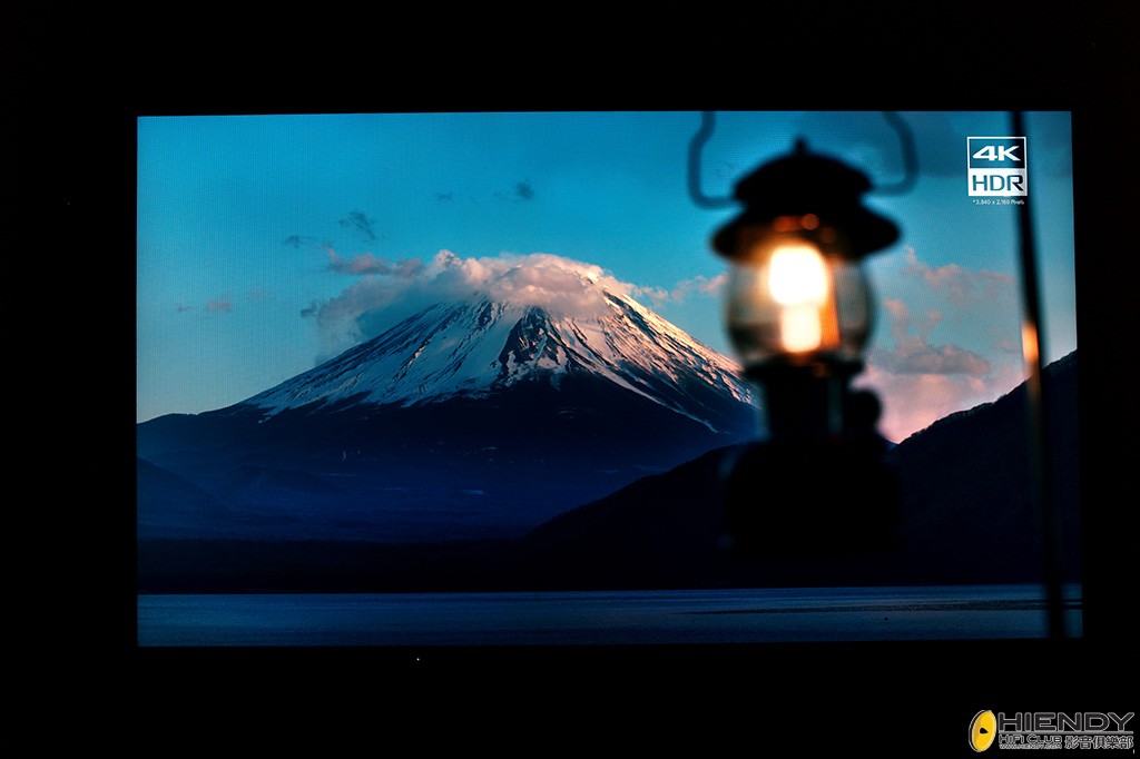

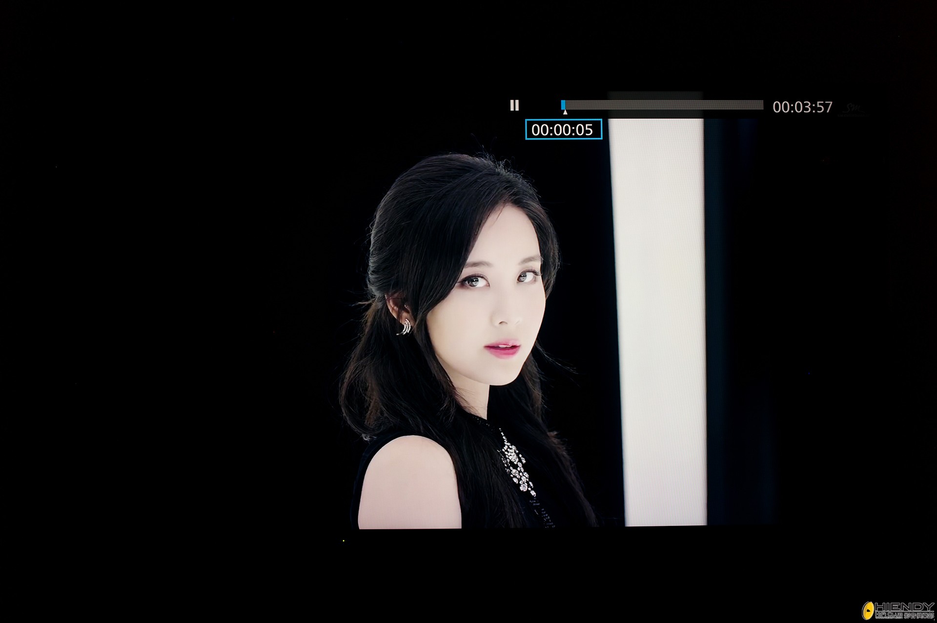

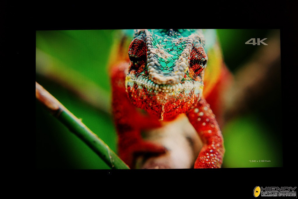

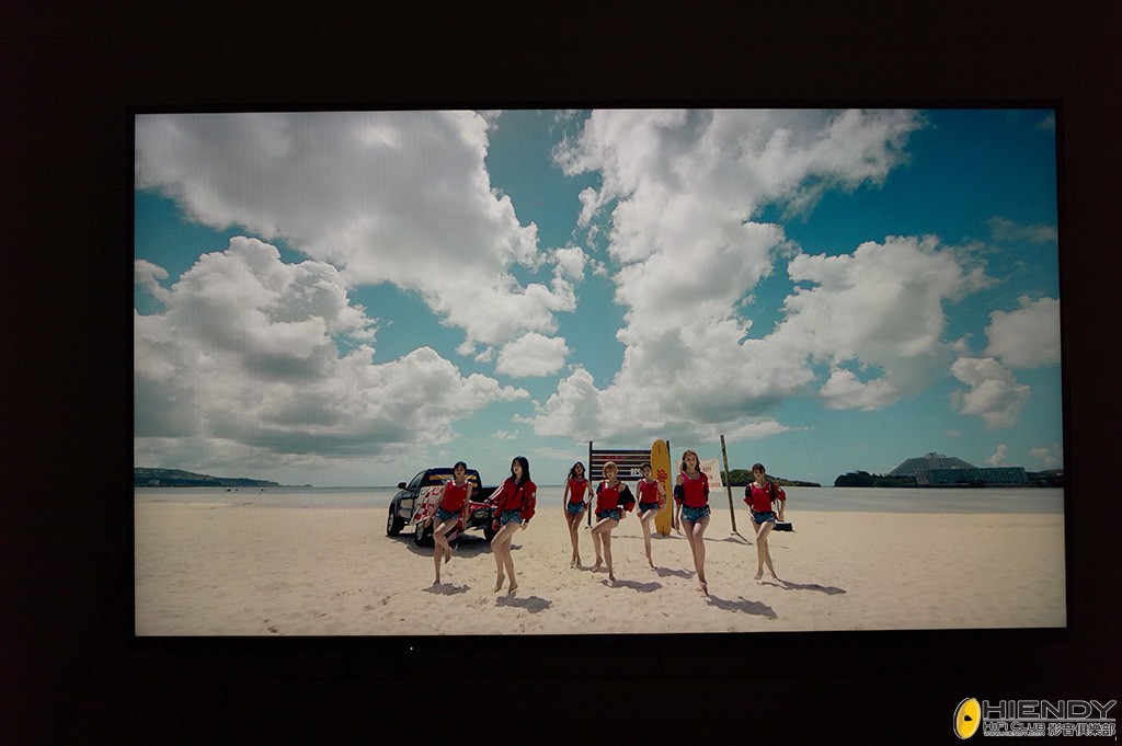

Moreover, I also attach some capture about 1080P youtube , 4K , 4k HDR  movie sample (Please note that the color of attached capture may has some deviation to the original ( it is too difficult to take the picture)

Gray scale measurement
1080p
1080p
1080P youtube
1080P youtube

樓主,可否影只girls day的darling Japanese version睇睇見識下

I saw your measured peak lumens is 108 nits only, you may try the following test patterns for UHD calibration, as it contents HDR10 and BT2020 test patterns, you might play those via usb plug in.
http://www.avsforum.com/forum/13 ... -test-patterns.html
