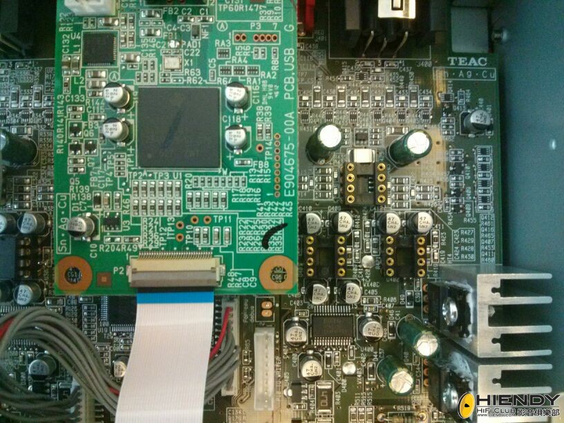

我仲未收到機

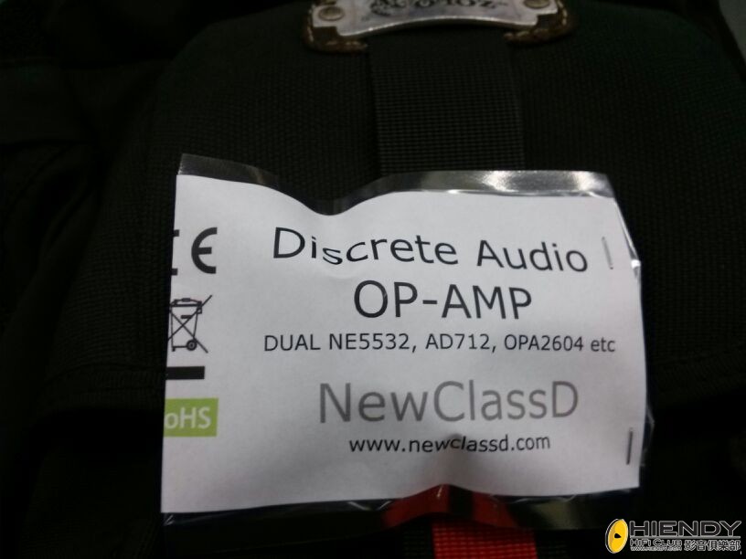

本帖最後由 minidetective 於 2013-7-3 11:03 編輯
ilccmcf 發表於 2013-7-3 04:35
我已經為你們入定D好野
我都摩咗喇,用4粒Muses 01加兩粒Discrete New Class D,聲音表現簡直美不聲收,美靘不可方物.ilccmcf提供之Opamp組合真係非常正.下一步會試吓用六粒Discrete New Class D睇吓聲音會否更進一步
發表於 2013-7-3 11:05:27 | 顯示全部樓層
minidetective 發表於 2013-7-3 10:57
我都摩咗喇,用4粒Muses 01加兩粒Discrete New Class D,聲音表現簡直美不聲收,美靘不可方物.ilcc ...

Hi minidetective,
I have 4 pcs NewClassD dual opamps in house. If you want to try 6 pcs in the UD-501, pls PM me to arrange a day.
發表於 2013-7-3 11:40:33 | 顯示全部樓層
diwily 發表於 2013-7-3 11:39
Hi minidetective,
I have 4 pcs NewClassD dual opamps in house. If you want to try 6 pcs in the UD-5 ...
Noted with thanks.

minidetective 兄:  快D試 ~~~~ 不過小心D !!! 位置上有D迫

本帖最後由 minidetective 於 2013-7-3 11:56 編輯
ilccmcf 發表於 2013-7-3 11:42
機本上直插係唔夠位要用adapter加延長線至得.另外換咗opamp後,我用Denon S10做轉盆經同軸去Teac UD-501後聲音表現拍得住DSD哦
發表於 2013-7-3 11:50:17 | 顯示全部樓層
minidetective 發表於 2013-7-3 11:48
好似好牙煙..... 哈

發表於 2013-7-3 11:55:12 | 顯示全部樓層
I have DIP8 gold-plated sockets [from Taiwan] & 0.5mm cryo silver wire [from U.S.] to fabricate adaptors too. Can use also Mundorf solder wire with 9.5% silver for best result.
發表於 2013-7-3 12:02:24 | 顯示全部樓層
diwily 發表於 2013-7-3 11:55
I have DIP8 gold-plated sockets [from Taiwan] & 0.5mm cryo silver wire [from U.S.] to fabricate adap ...
師兄,你有好多補品喔,有冇已經焊好之制成品看看,如有可快點到我處試吓.因為我都訂緊DIP8 socket.
