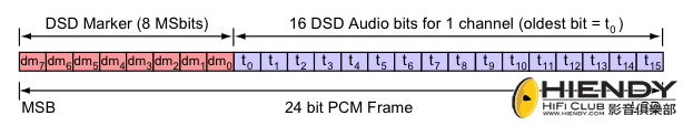

發表於 2014-8-13 17:42:27 | 顯示全部樓層
alonIV 發表於 2014-8-13 17:00
我上網睇返黎dsd over pcm等於dop,我英文唔多好,我以為係dsd以pcm既模式輸出就係dop,乜原來仲有其他意思 ...
DoP係指Transfer DSD over PCM而唔係Convert DSD to PCM
方法係將原本的DSD streaming訊號每16bit加上8bit的特別maker扮成24bit的PCM訊號(其實不是PCM訊號)來瞞過OS只可傳送PCM的I/O機制, 只要使用支援DoP的DAC接收,  DAC見到前8bit的maker就懂得解拆出後面的16bit原生DSD訊號並解碼。

發表於 2014-8-13 17:55:49 | 顯示全部樓層
nicknick 發表於 2014-8-13 17:42
方法係將原本的DSD streaming訊號每16bit加上8b ...
咁你聽既係唔係pcm呀,講咁多理論做乜
發表於 2014-8-13 17:59:48 | 顯示全部樓層
如果dop唔係pcm,又唔係dsd,咁你講下係乜,仲有點解一部可以硬解dsd既dac要以dop輸出

發表於 2014-8-13 18:39:42 | 顯示全部樓層
alonIV 發表於 2014-8-13 17:59
如果dop唔係pcm,又唔係dsd,咁你講下係乜,仲有點解一部可以硬解dsd既dac要以dop輸出 ...
DoP is method to put DSD inside the PCM packet and making transmission with PCM transmission protocol.
A bridge(protocol) only designed to let Sheep(PCM) to across, a wolf(DSD) take a Sheep Skin and walk over the bridge, then taking off the Sheep skin and into Wolf again, for start to end, he is still a wolf all the way without really becoming the sheep, but taking pathway of existing for Sheep (PCM).
