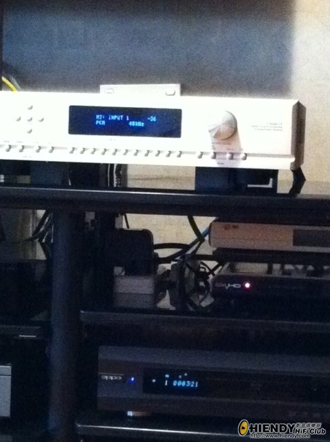

各位CHing,這個95 蠢東西,用Cary 提供的方法攪店了,謝謝各位提不同意見,
而且學到不同的音響知識,這就是上Hiendy 的樂趣!

Herman 兄,剛剛Cary代理告知一個方法,先把HDMI switch 去和oppo 輸入不同的選擇!如oppo 95 插 hdmi 1  ...
Sunny 發表於 2011-6-11 10:02
    唔係好明點做,可否講多些. ths.....
 樓主| 發表於 2011-6-12 09:38:09 | 顯示全部樓層
Ching 你先按某一個HDMI 插不是 Oppo-95 插的,如你的95插第一個HDMI ,這樣你找第二,第三或第四。在聽歌時,先把 Cary12 的 HDMI 選第二,第三或第四,之後按 input 1 就成,不明的給我你的電話再告訴你!
發表於 2011-6-12 11:01:37 | 顯示全部樓層
Ching 你先按某一個HDMI 插不是 Oppo-95 插的,如你的95插第一個HDMI ,這樣你找第二,第三或第四。在聽歌 ...
Sunny 發表於 2011-6-12 09:38
方法可行,謝謝Sunny兄提供方法
 樓主| 發表於 2011-6-13 08:45:14 | 顯示全部樓層
Dear All,
Please find Oppo's reply as below...
This is an issue with the Cary 12 not going into HDMI Standalone Mode when the projector is hot. What is happening is that the receiver remains in HDMI Repeater Mode, so it is trying to send all HDCP information to the projector. Since the projector is off, the HDCP fails, so the player disengage all audio output. The receiver should normally switch to HDMI Standalone Mode when the HDMI output is no longer available.
If you remove the HDMI cable from the back of the receiver which normally goes to your projector, then start a CD or SACD, do you have the same errors?
Also try upgrading the firmware on your player (http://oppodigital.com/blu-ray-b ... mware-50-0608B.aspx) and the receiver (if possible).
Best Regards,
Customer Service
OPPO Digital, Inc.
2629B Terminal Blvd.
Mountain View, CA 94043
[email protected]
Tel: 650-961-1118
Fax: 650-961-1119
發表於 2011-6-13 09:41:38 | 顯示全部樓層
Oppo講出咗個原因
