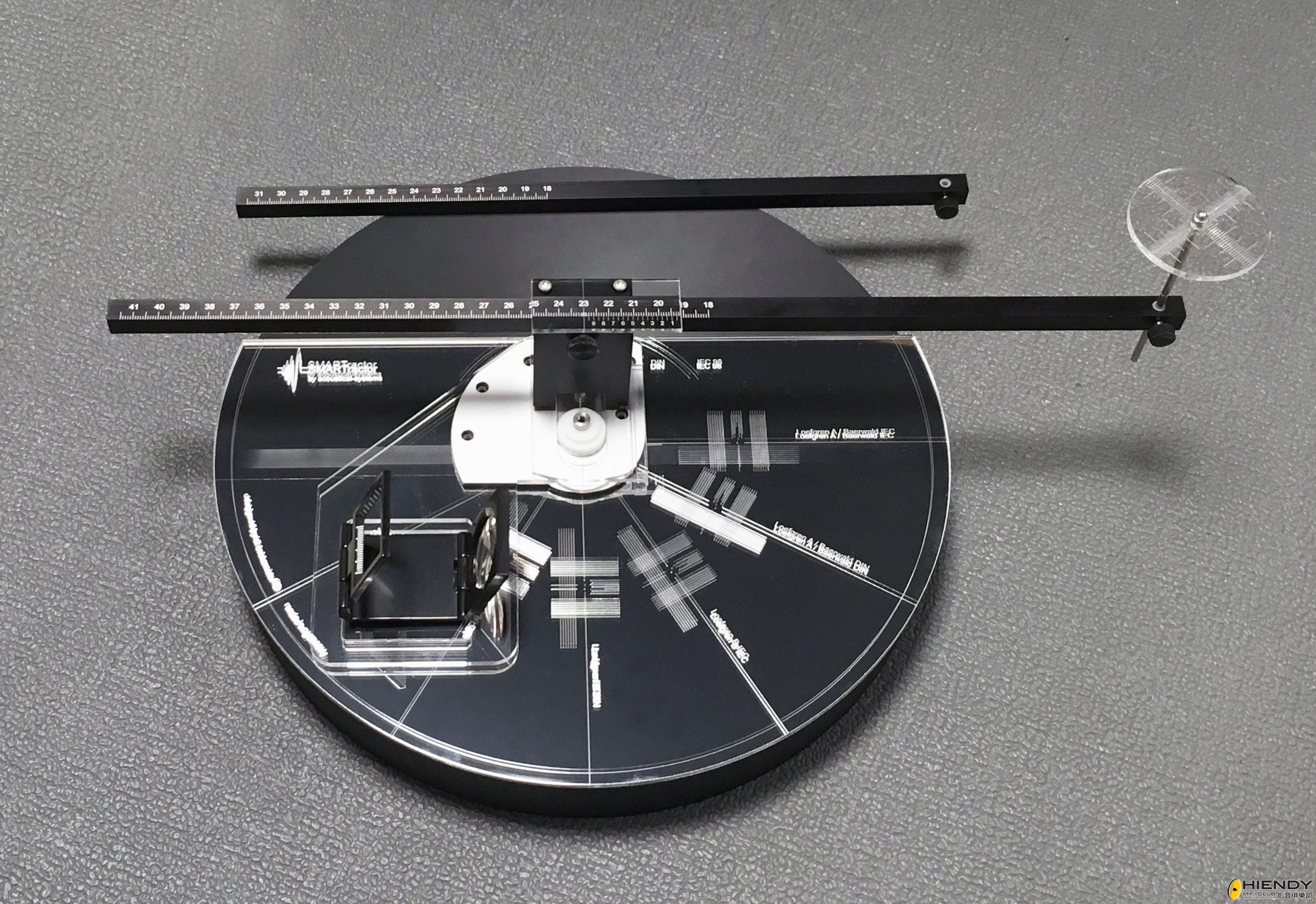

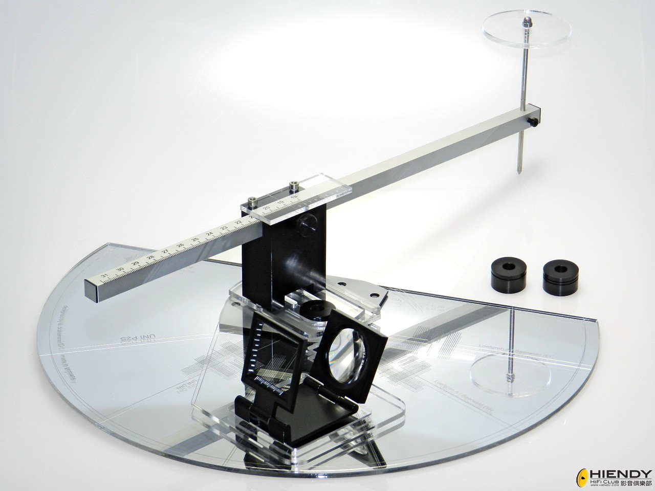

The SMARTractor is probably the finest, most intelligently designed tonearm alignment tool available on the market.  Typically German, it is beautifully made, with really thoughtful provision of features that make accurately setting up a tonearm ridiculously easy.  Do you think that you can do it better by eye?  Most turntable users never go back to manual setup methods, after using a tool like this!
Read this review from the Audio Beat and understand why this is special and better than any alternative – http://www.theaudiobeat.com/blog/smartractor.htm
So, what’s special about the SMARTractor?
The SMARTractor now comes with one nylon centre bush, with a universal ‘gripping’ insert that is much easier to use than the previous arrangement of 3 separate bushes to accommodate different spindle sizes.
A unique bundle of features:
The SMARTractor comes with 5 tangential curves combined in 1 template.
the SMARTractor’s template is made from 3mm (= same thickness as 180 gr LP) strong premium grade german XT mirrored acrylic supplied by Evonik.
no-error-possible single-point alignment with 3mm deep parallax which means you can line up the cartridge cantilever very accurately against the calibrated marking and their reflections – you can be 100% sure that you’re looking from the correct angle.
enables you to precisely align a cartridge according to its cantilever, rather than the body sides.  Ever tried to align a cartridge body that does not have straight sides?  No problem at all with the SMARTtractor, even when the body obscures the cantilever.
super easy to use with 1-point fixed setting for every tangential curve.
all alignment lines are cnc-laser cut hairlines.
incorporates real glass aluminum-frame magnifier with automatic focus jig for unrivalled precise magnified view during alignment.
all 5 tangential alignments are based on true triangular positioning and thus are independent of effective length and thus suitable for ALL pivot tonearms, no matter what their effective length or mounting position.
The SMARTractor further comes with in-built direct mounting distance – P2S -measurement with 0.05mm accuracy.
The total of 5 tangential options of course includes the old audio phono standards set by Loefgren and Baerwald in the late 1930s and 1940s in both – IEC and DIN – norms:
-Loefgren A / Baerwald DIN
-Loefgren A / Baerwald IEC
-Loefgren B DIN
-Loefgren B IEC
-UNI-DIN
The SMARTractor also features the critically acclaimed UNI-DIN tangential curve.   An all new tangential curve which is the latest calculation and the first one which does really take into account the special requirements and circumstances of a stereo stylus tracking a non linear stereo groove with increasing differences between the two groove walls.  In the last 2/3 of the record’s groove, the UNI-DIN curve offers significant (18-45%) less average – as well as less total! – distortion than Baerwald or Loefgren.  The UNI-DIN tangential alignment is available only in the SMARTractor and the UNI-Protractor from Acoustical Systems.    Sonically this gives you less stress on human (female) voices, more subtle details, less “grain”, increased “air” and considerable more “headroom” in critical passages and especially so in climaxes.
The SMARTractor does not give you an option for Stevenson alignment – this is because Stevenson trades notably higher tracing error and distortion over most of the record for lower distortion at the inner grooves, so it’s a worse compromise than Loefgren B or UNI-DIN (see graph below, linked to Analog Planet article by Michael Fremer).
Why 5 different options for alignment of cartridge/tonearm?
The vast number of tonearms introduced in the past 40 years not only display a large number of different concepts, but also a considerable diversity in geometries.  Furthermore it makes a significant difference whether the record we want to track with best possible results is a modern pressing with a very long run-out/lead-out (‘unmodulated groove’ or ‘dead wax’), or whether the record’s groove is cut close to the paper inner label.   The latter is often found with countless records made in the early stereo years from 1958 up till 1974.  The SMARTractor takes into account the diversity of geometries found in pivot tonearms – as well as the different situations in records past and present.
The SMARTractor offers the best possible tangential curve for every requirement, for every pivot tonearm – as well as for every record collection;  and it makes sure that the serious audiophile gets the most perfect, utmost precise alignment possible.
Even more important, this ultra precise result is achieved swift, with ease and free of any possible error, without the need for any specialist knowledge, nor special manual skills.   Setting up your analog front-end with unparalleled precision – and with the BEST SONIC results obtainable – is only a matter of a few minutes when using the SMARTractor.

SMARtractor 附3組spindle size adaptor.  供不同粗幼spindle 使用.  實試分別明顯!
